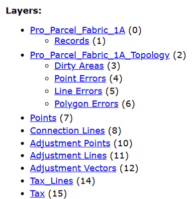

The ArcGIS Python API allows one to access GIS data from ArcGIS Enterprise, file-based data such as file geodatabase feature classes and shapefiles. One can also work with OGC data, GeoJson and spatially enabled files like CSV and Excel sheets. When discussing the "feature" terms in the ArcGIS Python API context, we're dealing with Pythonic object types.
When accessing data from ArcGIS Enterprise, there are typically three types of objects representing feature data.
FeatureLayerCollection:
A Feature Layer Collection is a representation of a Feature Service. A feature layer collection can have one or more feature layers within.
FeatureLayerCollection: arcgis.features module | ArcGIS API for Python | Esri Developer
FeatureLayer:
Consider a feature layer a single item in a feature layer collection. A feature layer can also be accessed directly but it will only represent one GIS entity.
FeatureLayer: arcgis.features module | ArcGIS API for Python | Esri Developer
FeatureCollection:
Ugh, I know. A FeatureCollection object is an in-memory collection of features. It is an object that has a layer definition and a FeatureSet.
FeatureCollection: arcgis.features module | ArcGIS API for Python | Esri Developer
FeatureSet / Feature:
A feature set is collection of features. Think of a FeatureSet as a query with multiple results returned. A single result would be a feature.
FeatureSet: arcgis.features module | ArcGIS API for Python | Esri Developer
Feature: arcgis.features module | ArcGIS API for Python | Esri Developer
So it looks like context matters. There are many concepts wrapped up in very similar sounding terms and many of those terms are used interchangeably. In my experience, it boils down to a feature is one entity, feature classes and feature layers are collections of similar features and collections are many feature layers in one collection.
