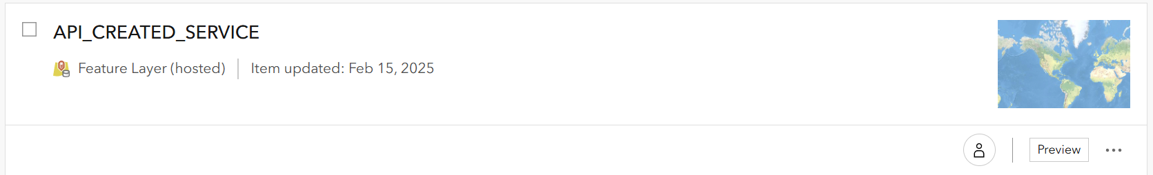

The create Feature Service content item.

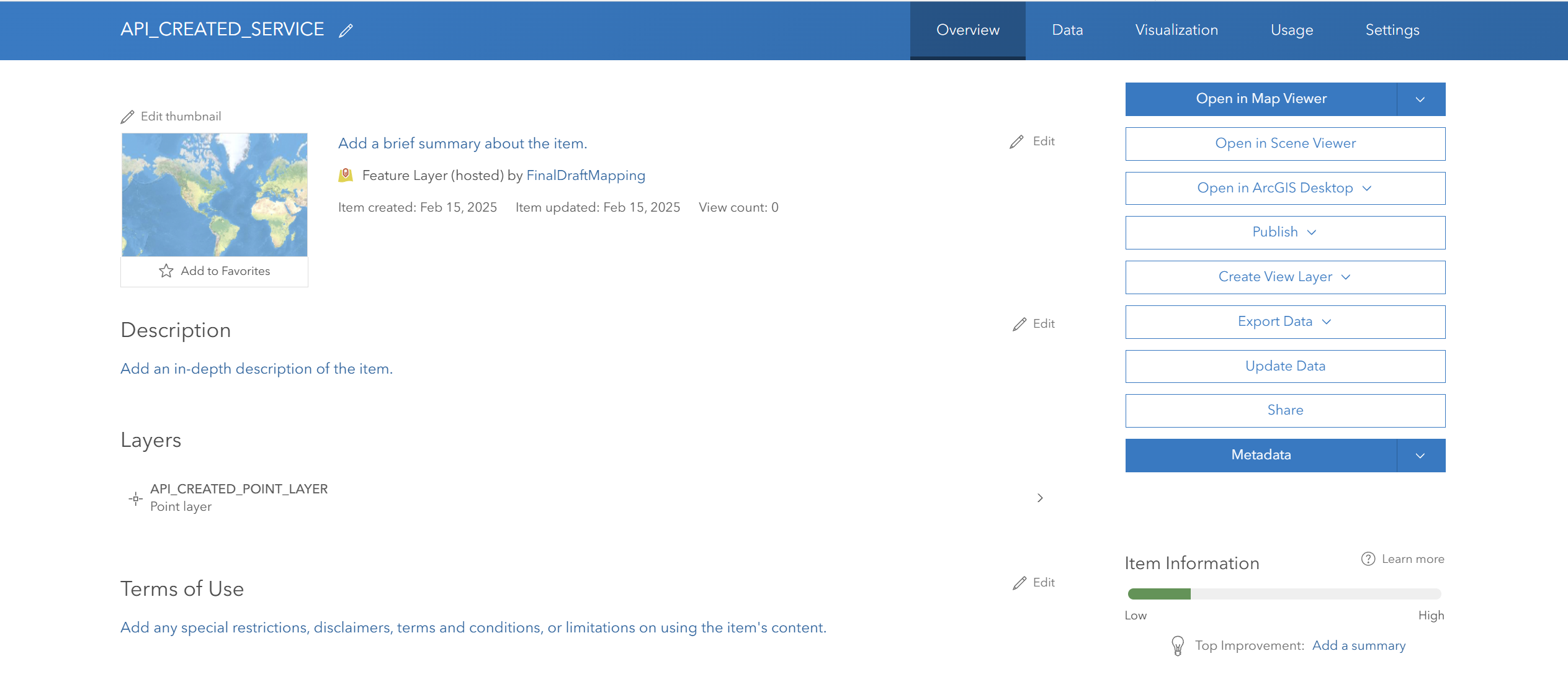

The service item homepage.

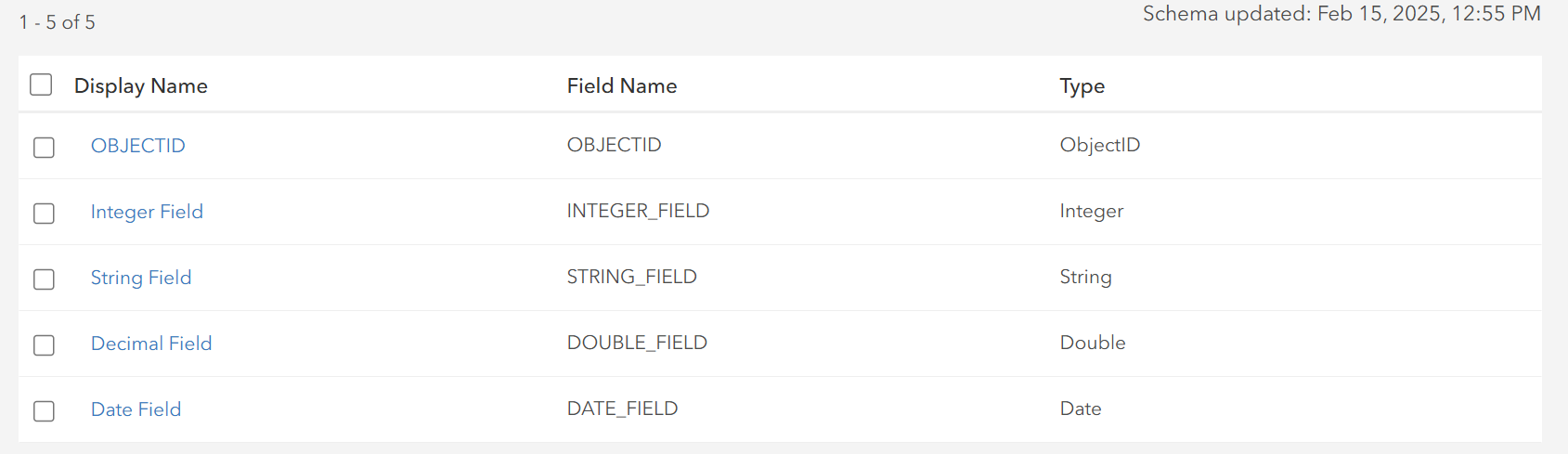

The fields created.
