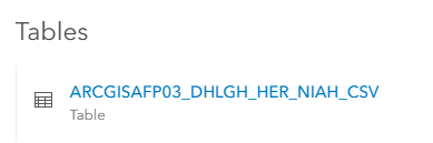

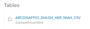

However, if you have a table or tables in your WebMap, calling the update() method can cause all or one of the tables to become "corrupt". The Table type switches to a SubtypeGroupTable rather than a Table.
Pre-update...
Post-update...

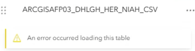

You cannot access the table when you open the WebMap, when you go to the tables tab it will state that an error occurred loading this table.
