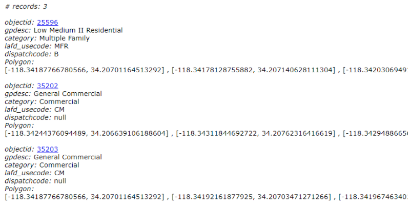

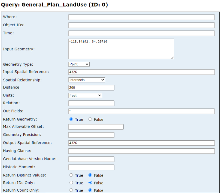

Here is a screenshot of my parameters; The geocoding point is actually closer to Commercial but the top candidate shows Residential.
