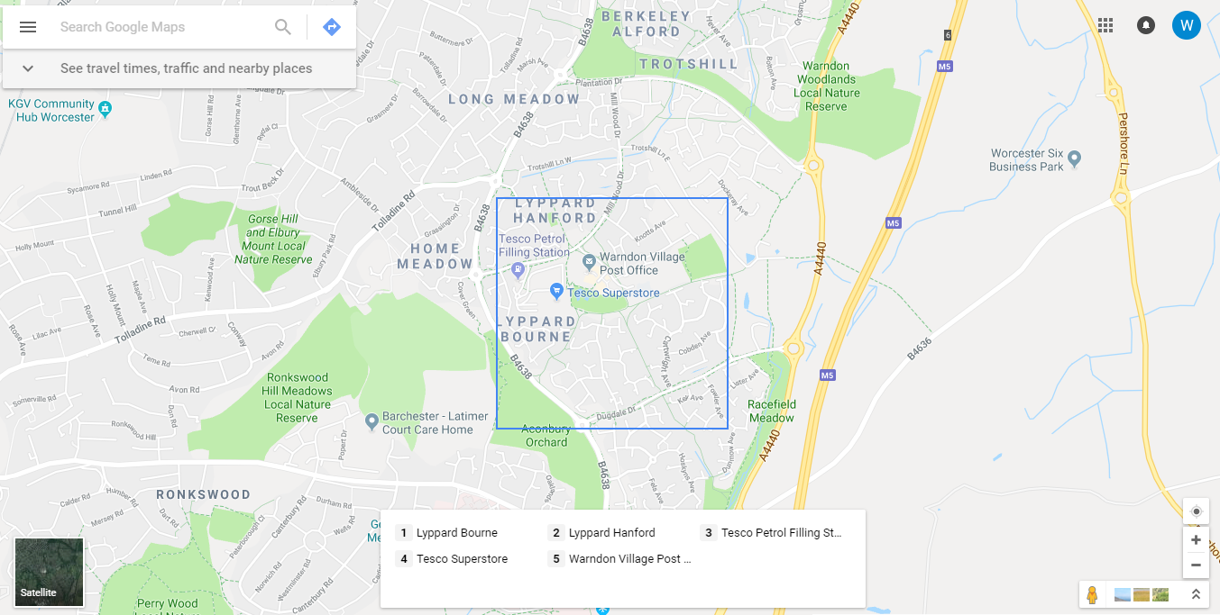

I am looking into the accessibility of my created maps. Which has been going quite well with moving the map with just the keyboard using the arrow keys and zooming in with "+" and "-".
However one of the biggest hurdles that i am coming across is identify features without the use of the click of the mouse but just using the keyboard by itself.
So my question is basically has anyone come across this problem before and have managed to get something working or am i missing something that allows me to do this?
I do know google maps have a blue square graphic which when you pan the map identifies any features that are inside the graphic and you can can get the attributes of the feature by pressing the relevant number to the name.  (See image below).
Many Thanks,
James
