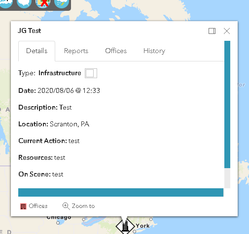

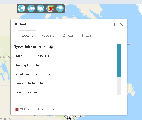

Here is what it looked like using ESRI 4.13:
Here is what it looks like after upgrading to ESRI 4.15:
Notice the HTML img is missing in the 4.15 popup, and this is our problem.
