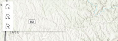

What this does against my expectations create a table with three rows, each with one cell, i.e. the three widgets are stacked one upon the other.

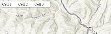

How, if I try just putting some text in the cells - either using .innerHTML or as below, that works fine.
cell1.append("Cell 1");
cell2.append("Cell 2");
cell3.append("Cell 3");
Any idea how to make this work, or other suggestions for creating a horizontal strip or toolbar to hold a number of widgets?
