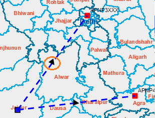

Hi,
I am trying the plot the arrow symbols along the direction of the line, but its not working properly. PFB image
one arrow symbols shows correct direction but other do not, PFB code for getting the angle:
//Create Line from two points
var line = new Polyline();
line.addPath([pt1,pt]);
var lineGraphics = map.graphics.add(new Graphic(line,lineSymbol ));
lineGraphics.setGeometry(line);
//Get mid point of a line
var midPoint = lineGraphics._extent.getCenter();
//Get angle for the line
var angle = this._getAngle(lineGraphics.geometry.paths[0][0],lineGraphics.geometry.paths[0][1]);
var picSymbol= new PictureMarkerSymbol();
picSymbol.setUrl("css/images/filled-arrow.png");
picSymbol.setHeight(12);
picSymbol.setWidth(12)
picSymbol.setAngle(angle);
map.graphics.add(new Graphic(midPoint,picSymbol));
_getAngle:function(p1,p2){
var srtPnt = p2[1]-p1[1];
var endPnt= p2[0]-p1[0];
var angle =((180/Math.PI)* Math.atan2(srtPnt,endPnt));
return angle-180;
What changes need to be done to get proper angle?
