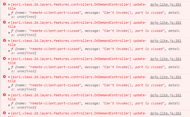

The issue is right when it calls the
appConfig.activeView.container = null;
it starts throwing errors in the console as below:
and also below error on complete execution
And my 3D renderers don't come up.

            // mapView instance. Set the container on the mapView and flag
            // it as the active view
            featureLayer.renderer = appConfig.injuryLayerRend2D;
            appConfig.mapView.viewpoint = activeViewpoint;
            appConfig.mapView.container = appConfig.container;
            appConfig.activeView = appConfig.mapView;
            switchButton.value = "3D";
          } else {
            //featureLayer.renderer = objectSymbolRenderer;
            appConfig.sceneView.viewpoint = activeViewpoint;
            appConfig.sceneView.container = appConfig.container;
            appConfig.activeView = appConfig.sceneView;
            switchButton.value = "2D";
        // convenience function for creating a 2D or 3D view
        function createView(params, type) {
          var view;
          var is2D = type === "2d";
          if (is2D) {
            view = new MapView(params);
            return view;
          } else {
            view = new SceneView(params);
          return view;
    </script>
