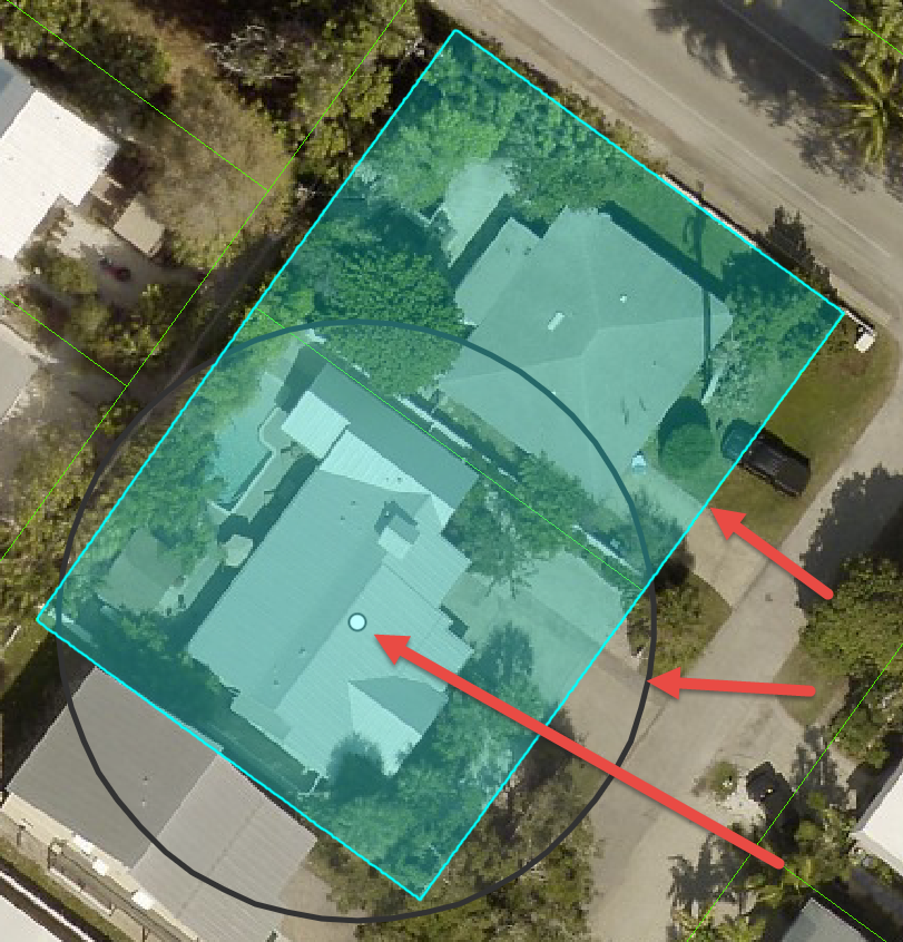

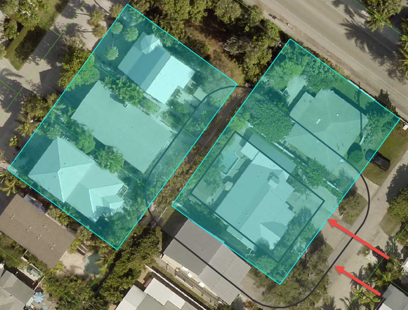

I am using a point widget to select an area on the map and highlight it. I then provide a geodesicBuffer to add distance in feet to query for intersecting areas. This is working, but the measurement is taken from the point when I need it taken from the bounding box. Is there a way on create to change the geometry type from a type point to a type rectangle?
Point widget. Buffer distance needs to be from bounding box, not point.
Polygon widget. Buffer selection is correct.

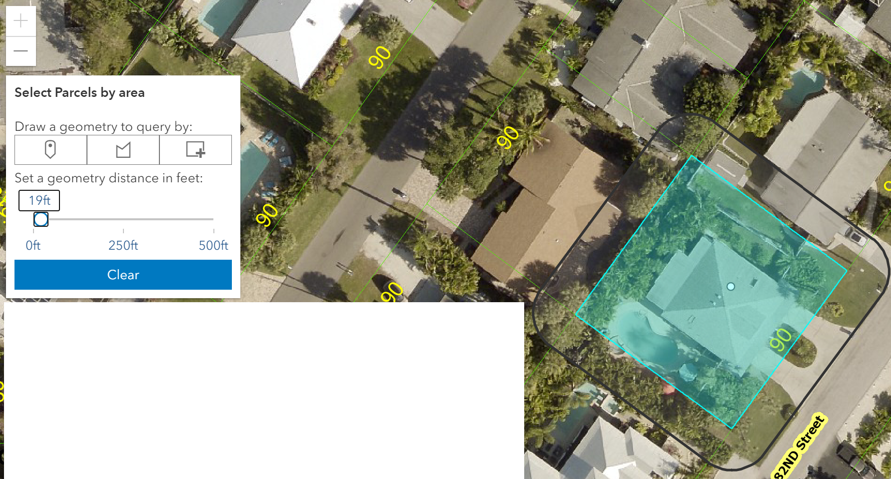

Ok, Robert. Thanks you. I think it's sort of working for me with your instructions. As you can see from the screenshot, the buffer distance is started from the selection. I have further work to do, but it's looking a lot better.
Maybe not a best approach. I can probably improve the feature layer query. The part that got it working was to convert the clicked point to a map point and then query my feature layer to get the geometry.
