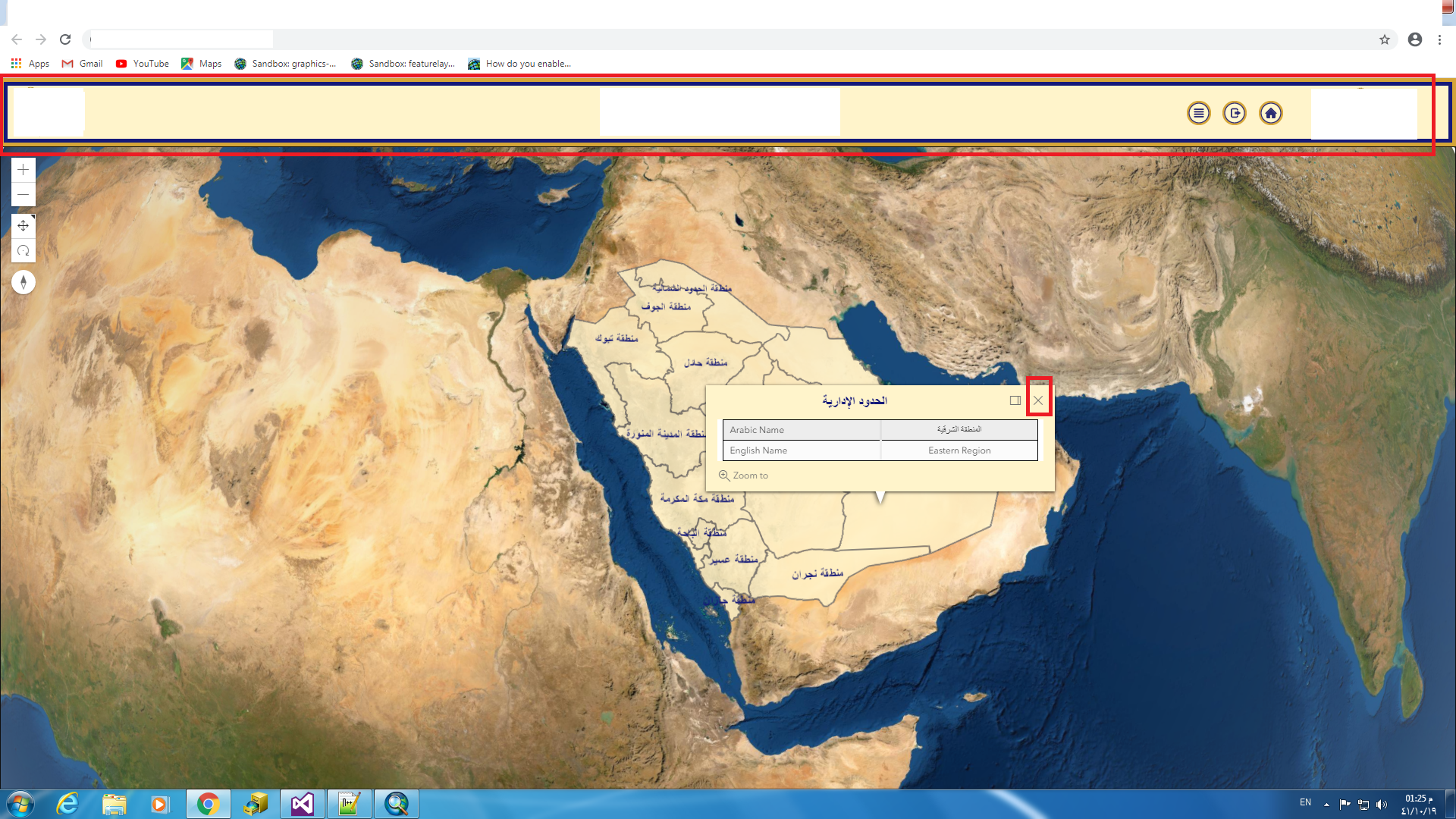

i need urgent help.i have my custom page.on page i use bootstrap to create a navigation bar.As you see in the bellow image as highlited in red rectangle.if i click on my scene view it shows a popup with some information.if i use to close popup from cross button.when i press cross button of popup my navigation bar also disappeared.as you see in the other image.
please help me to solve this issue.i am using4.15 arcgis api.i am using scene view.
Thanks once again.waiting for reply.

Nadir,
   Sounds like you have a css rule specificity issue. Meaning that you are using some generic css class name like .hidden, .hide , .visible , or the like and esri is using the same class to hide its' popup. Thus when the popup is hidden so is your toolbar. Try making your css rule and class name that hides your navigation tools more specific.
GeorgeAbraham
Hi Nadir Hussain,
As Robert Scheitlin, GISP mentioned above, the issue seems very specific to an incorrect CSS implementation. If you could share a working code, then could take a further look and fix it for you.

PageMethods.getTotalMinerals("5", OnSuccessMinerals, OnError);
}, 5000);
catch (err) {
txt = "There was an error on this page.\n\n";
txt += "Error description: " + err.message + "\n\n";
txt += "Click OK to continue.\n\n";
alert(txt);
$('#SearchButton6').bind('click', function () {
var progressBarVal = 100;
try {
$('#pBar').css('visibility', 'visible');
$('#pBar').css('display', 'block');
chartCaption = "الوضع الراهن الاحتياطي التعدينى";
setTimeout(function () {
$('#pBar').css('visibility', 'hidden');
dynamicPanel();
setView();
var featureLayer1 = new FeatureLayer({
url: "",
outFields: ["*"]
featureLayer1.queryFeatures().then(function (results) {
// prints an array of all the features in the service to the console
console.log(results.features);
graphicsLayer.removeAll();
addGraphics(results, "مجمعات الأنشطة التعدينية المعتمدة");
chartCaption = "الوضع الراهن المجمعات التعدينية",
PageMethods.getTotalProjects("6", OnSuccessTaadeen, OnError);
PageMethods.getTotalMinerals("6", OnSuccessMinerals, OnError);
}, 5000);
catch (err) {
alert(txt);
$('#SearchButton7').bind('click', function () {
try {
dynamicPanel();
setView();
url: "",
outFields: ["*"]
//map.add(featureLayer1);
addGraphics(results, "موقع إحتياطى تعدينى");
PageMethods.getTotalProjects("7", OnSuccessTaadeen, OnError);
PageMethods.getTotalMinerals("7", OnSuccessMinerals, OnError);
}, 5000);
catch (err) {
alert(txt);
function addGraphics(result,Title) {
var strContents;
var strHeader = "";
var template = null;
result.features.forEach(
function(feature){
var point1 = { type: "point", x: feature.geometry.extent.center.x, y: feature.geometry.extent.center.y};
strHeader = "<thead><tr><th align=center bgcolor=#FFF4CB><font-weight=bold><font color=#14197A><font-size=large>Values</th><th align=center bgcolor=#FFF4CB><font color=#14197A><font-size=large>Name</th></tr></thead><tbody>";
if(Title!=="موقع إحتياطى تعدينى" && Title!=="مجمعات الأنشطة التعدينية المعتمدة"){
//alert(Title);
strContents = setContents(feature);
strHeader = "<font size=2 face=Courier New><table width=100% border='2px solid black' direction='initial' >" + strHeader + strContents + "</tbody>" + "</table></font>";
template = new PopupTemplate({ title: Title, content: strHeader, actions: [zoomOutAction], overwriteActions: true });
strHeader="";
var g = new Graphic({
geometry: point1,
attributes: { FExtent: feature.geometry.extent, feature: feature },//feature.attributes,
symbol: { type: "simple-marker", color: [0, 0, 0], outline: { width: 2, color: [0, 255, 255], }, size: "10px" },
popupTemplate: template
//popupTemplate: { title: Title, actions: [ { id: "moadBina",
//image:"https://developers.arcgis.com/javascript/latest/sample-code/popup-custom-action/live/beer.png",
//title: "Brewery Info"
graphicsLayer.add(g);
map.add(graphicsLayer);
function setContents(feat){
var strContent = "";
//if (idResult.layerId != 5) {
// dblArea1 = feat.feature.attributes.Area_Zone / 1000000;
// dblArea1 = dblArea1.toFixed(3);
//else {
var dblArea1 = feat.attributes.Area_Zone;
strContent = "";
strContent = "<tr align=center bgcolor=#FFF4CB color=#14197A>" + "<td align=center style=color:#14197A>" + feat.attributes.اسم_الشركة + "</td>";
strContent = strContent + "<td align=center style=color:#14197A>" + "اسم الشركة" + "</td>" + "</tr>";
strContent = strContent + "<tr align=center bgcolor=#FFF4CB color=#14197A>" + "<td align=center style=color:#14197A>" + feat.attributes.الامارة;
strContent = strContent + "<td align=center style=color:#14197A>" + "الامارة" + "</td>" + "</tr>";
strContent = strContent + "<tr align=center bgcolor=#FFF4CB color=#14197A>" + "<td align=center style=color:#14197A>" + feat.attributes.الموقع;
strContent = strContent + "<td align=center style=color:#14197A>" + "الموقع" + "</td>" + "</tr>";
strContent = strContent + "<tr align=center bgcolor=#FFF4CB color=#14197A>" + "<td align=center style=color:#14197A>" + feat.attributes.نوع_الخام;
strContent = strContent + "<td align=center style=color:#14197A>" + "نوع الخام" + "</td>" + "</tr>";
strContent = strContent + "<tr align=center bgcolor=#FFF4CB color=#14197A>" + "<td align=center style=color:#14197A>" + feat.attributes.رقم_القرار;
strContent = strContent + "<td align=center style=color:#14197A>" + "رقم القرار " + "</td>" + "</tr>";
strContent = strContent + "<tr align=center bgcolor=#FFF4CB color=#14197A>" + "<td align=center style=color:#14197A>" + convertDateFormat(feat.attributes.تاريخ_القرار);
strContent = strContent + "<td align=center style=color:#14197A>" + "تاريخ القرار " + "</td>" + "</tr>";
strContent = strContent + "<tr align=center bgcolor=#FFF4CB color=#14197A>" + "<td align=center style=color:#14197A>" + convertDateFormat(feat.attributes.الانتهاء);
strContent = strContent + "<td align=center style=color:#14197A>" + "تاريخ الانتهاء " + "</td>" + "</tr>";
strContent = strContent + "<tr align=center bgcolor=#FFF4CB color=#14197A>" + "<td align=center style=color:#14197A>" + dblArea1;// feat.feature.attributes.Area_Zone;
strContent = strContent + "<td align=center style=color:#14197A>" + "المساحة" + "</td>" + "</tr>";
//if ((idResult.layerId == 6) || (idResult.layerId == 7) || (idResult.layerId == 9)) {
// strLyr = getPath(idResult.layerId, feat.feature.attributes.OBJECTID_12, "");
// strContent = strContent + "<tr>" + "<td align=center colspan=2 font-size: large;font-weight: 600;color:blue;font-family: 'Helvetica Neue',Helvetica,Arial,sans-serif;>" + "<a href=" + strLyr + ">المزيد من المعلومات</a> " + "</td>"
//else {
strLyr = getPath(5, feat.attributes.OBJECTID_1, "");
strContent = strContent + "<tr align=center bgcolor=#FFF4CB>" + "<td align=center colspan=2 font-size: large;font-weight: 600;color:blue;font-family: 'Helvetica Neue',Helvetica,Arial,sans-serif;>" + "<a href=" + strLyr + ">المزيد من المعلومات</a> " + "</td>"
return strContent;
/* view.on("click", function(screenPoint) {
view.hitTest(screenPoint)
.then(function(response){
// do something with the result graphic
var graphic = response.results[0].graphic;
feat=graphic.attributes.feature;
fExt=graphic.attributes.FExtent;
view.popup.open({location: screenPoint, features: [graphic]});
//view.when(function () {
// alert("Hello graphic");
// // Watch for when features are selected
// view.popup.watch("selectedFeature", function (graphic) {
// if (graphic) {
// // Set the action's visible property to true if the 'website' field value is not null, otherwise set it to false
// var graphicTemplate = graphic.getEffectivePopupTemplate();
/*view.popup.watch("selectedFeature", function (graphic) {
alert("Hello");
if (graphic) {
graphicTemplate.actions.items[0].visible = graphic.attributes.website ? true : false;
var pointGraphic = new Graphic({
symbol: {
type: "simple-marker", // autocasts as new SimpleMarkerSymbol()
color: [0, 0, 139],
outline: {
color: [255, 255, 255],
width: 1.5
function queryFeatures(screenPoint) {
const point = view.toMap(screenPoint);
featureLayer.queryFeatures({
geometry: point,
// distance and units will be null if basic query selected
distance: null,
units: null,
spatialRelationship: "intersects",
returnGeometry: false,
outFields: ["*"]
.then(function (featureSet) {
// set graphic location to mouse pointer and add to mapview
pointGraphic.geometry = point;
view.graphics.add(pointGraphic);
// open popup of query result
view.popup.open({
location: point,
features: featureSet.features,
featureMenuOpen: true
// Call the appropriate DistanceMeasurement2D or DirectLineMeasurement3D
function distanceMeasurement() {
const type = activeView.type;
//measurement.activeTool = type.toUpperCase() === "2D" ? "distance" : "direct-line";
distanceButton.classList.add("active");
areaButton.classList.remove("active");
// Call the appropriate AreaMeasurement2D or AreaMeasurement3D
function areaMeasurement() {
measurement.activeTool = "area";
distanceButton.classList.remove("active");
areaButton.classList.add("active");
// Clears all measurements
function clearMeasurements() {
measurement.clear();
</script>
</head>
<body style="overflow-x:hidden;overflow-y:hidden;">
<div style="border:solid 5px #D5A538">
<nav class="navbar navbar-dark navbar-expand-md justify-content-between" style=" border:5px solid #14197A">
<div class="container-fluid" >
<div class="navbar-collapse collapse dual-nav w-50 order-1 order-md-0">
<a href="#" class="navbar-brand">
<img src="Images/leftLogo.png" width="65" alt="" class="d-inline-block align-middle " />
</a>
</div>
<a href="" class="navbar-brand mx-auto d-block text-center" style="color:black; font-family: 'DroidArabicKufiRegular';font-weight: normal;font-style: normal; font-size:xx-large;font-weight:900;color:#14197A">بوابة المعلومات التعدينية</a>
<div class="navbar-collapse collapse dual-nav w-50 order-2">
<ul class="navbar-nav ml-auto">
<li class="nav-item dropdown">
<div class="dropdown">
<button class="btn btn-primary dropdown-toggle" type="button" id="dropdownMenu1" data-toggle="dropdown" style="background-color:transparent;border:none;"
aria-haspopup="true" aria-expanded="false"><img src="Images/Menu3.png" style="margin-top:32px;margin-right:-5px" />
</button>
<div class="dropdown-menu dropdown-primary" style="background-color:#FFF4CB;">
<a class="dropdown-item myLabel" style="background-color:#FFF4CB;color:#14197A;font-family:DroidArabicKufiRegular" href="Main.aspx">رخص محاجر مواد البناء</a>
<a class="dropdown-item myLabel" style="background-color:#FFF4CB;color:#14197A;font-family:DroidArabicKufiRegular" href="ManajimAlsageera/Masharia.aspx">رخص المناجم الصغيرة</a>
<a class="dropdown-item myLabel" style="background-color:#FFF4CB;color:#14197A;font-family:DroidArabicKufiRegular" href="RukhsaTaadeen/TaadeenMasharia.aspx">رخص التعدين</a>
<a class="dropdown-item myLabel" style="background-color:#FFF4CB;color:#14197A;font-family:DroidArabicKufiRegular" href="MoadKhaam/KhaamMasharia.aspx">رخص محاجر مواد خام</a>
<a class="dropdown-item myLabel" style="background-color:#FFF4CB;color:#14197A;font-family:DroidArabicKufiRegular" href="Kashf/KashfMasharia.aspx">رخص الكشف</a>
<a class="dropdown-item myLabel" style="background-color:#FFF4CB;color:#14197A;font-family:DroidArabicKufiRegular" href="Magamaat/Moatmada.aspx">المجمعات التعدينية</a>
</div>
</div>
</li>
<li class="nav-item" >
<a class="nav-link" id="logout" href="Default.aspx">
<img src="Images/logout3.png" style="margin-top:30px" /> </a>
</li>
<li class="nav-item">
<a class="nav-link" href="Home.aspx">
<img src="Images/Home3.png" style="margin-top:30px"/>
</a>
</li>
<a class="nav-link" href="">
<img src="Images/newlogo2.png" width="170" alt="" class="d-inline-block align-middle mr-2 mt-1" />
</a>
</li>
</ul>
</div>
</div>
</nav>
</div>
<div class="container-fluid">
<div id="mainRow" class="row">
<div id="right" class="col col-sm-12 col-md-12 col-lg-12 col-xl-12">
<div id="viewDiv" style="left: 0px; right: 0px; bottom: 0px; top: 0px; height: 100vh">
</div>
<div id="topbar">
<button class="action-button esri-icon-measure-line" id="distanceButton" type="button" title="Measure distance between two points"></button>
<button class="action-button esri-icon-measure-area" id="areaButton" type="button" title="Measure area" ></button>
</div>
<div id="menu" class="esri-widget" style="border:solid 5px #14197A;background-color:#D5A538">
<a id="SearchButton1" href="#" class="dropdown-item myLabel" style="background-color:#FFF4CB;color:#14197A;font-family:DroidArabicKufiRegular;border:2px solid #14197A">رخص محاجر مواد البناء</a>
<a id="SearchButton2" href="#" class="dropdown-item myLabel" style="background-color:#FFF4CB;color:#14197A;font-family:DroidArabicKufiRegular;border:2px solid #14197A">رخص المناجم الصغيرة</a>
<a id="SearchButton3" href="#" class="dropdown-item myLabel" style="background-color:#FFF4CB;color:#14197A;font-family:DroidArabicKufiRegular;border:2px solid #14197A">رخص التعدين</a>
<a id="SearchButton4" href="#" class="dropdown-item myLabel" style="background-color:#FFF4CB;color:#14197A;font-family:DroidArabicKufiRegular;border:2px solid #14197A">رخص محاجر مواد خام</a>
<a id="SearchButton5" href="#" class="dropdown-item myLabel" style="background-color:#FFF4CB;color:#14197A;font-family:DroidArabicKufiRegular;border:2px solid #14197A">رخص الكشف</a>
<a id="SearchButton6" href="#" class="dropdown-item myLabel" style="background-color:#FFF4CB;color:#14197A;font-family:DroidArabicKufiRegular;border:2px solid #14197A">المجمعات التعدينية</a>
<a id="SearchButton7" href="#" class="dropdown-item myLabel" style="background-color:#FFF4CB;color:#14197A;font-family:DroidArabicKufiRegular;border:2px solid #14197A">الاحتياطي التعدينى</a>
</div>
</div>
<div id="left" class="col col-sm-0 col-md-0 col-lg-0 col-xl-0">
</div>
</div>
</div>
<div id="pBar" class = "progress" style="height:100px; width:100px;visibility:hidden;top:50%;left:45%;z-index:100;position:fixed;background-color:transparent;">
<img src="Images/loading.gif" height="100" width="100" />
</div>
<form id="Form1" runat="server">
<asp:ScriptManager ID="ScriptManager1" EnablePartialRendering="true" EnablePageMethods="true" EnableScriptGlobalization="true" runat="server" />
</form>
</body>
</html>
this is my code.here i remove url of my image service.pls check this.
