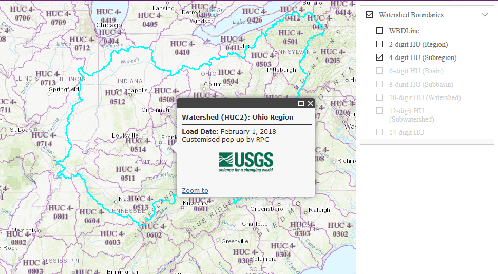

Here is a screenshot of a web map within the sample app for layer list. It shows the pop up for a layer that is set as visible within the web map.

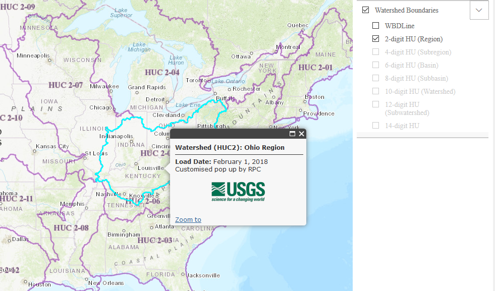

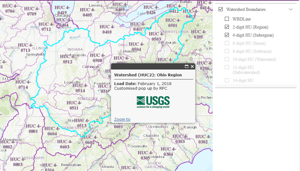

When I toggle the other layer on and zoom-in, I still get the pop-up of previous layer.
Even when I turn the layer's visibility off, I still don't get the pop-up of the now visible layer.

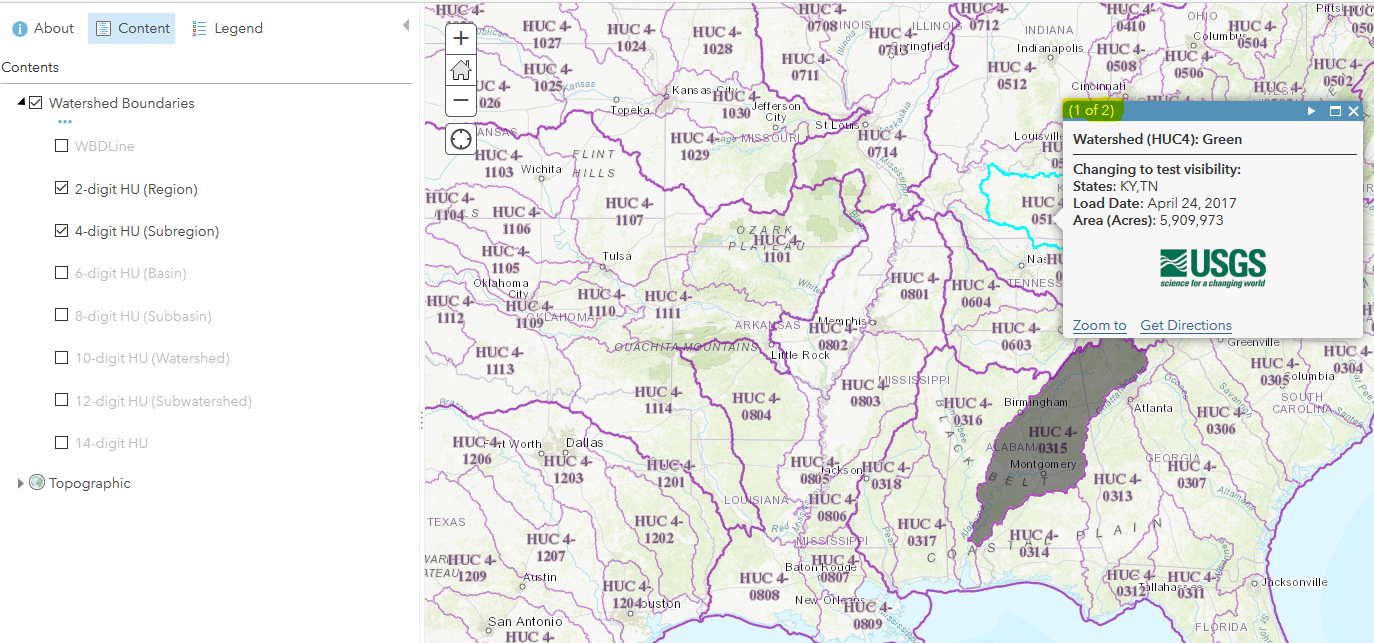

Whereas in the web-map, once the pop-up seems to be working as expected. It shows both the layer's pop-up, but it considers all visible layers.
