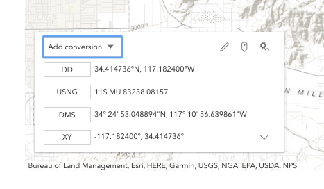

This is pretty close to what I'm looking for, but I've got my coordinate conversion widget in an expand widget. I'm trying to open all of the coordinate conversions once I initially press the expand button. I hope that makes sense.
So, once I press the expand button, I will see this (meaning that I would not have to hit the blue highlighted button to see all of the conversions):
I combined your sample and an expand functionality to help illustrate 90% of what I'm looking for.
