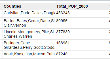

I have an OnDemandGrid which is getting populated from the attributes of the graphics in a featureLayer.  It's based on Select with Feature Layer | ArcGIS API for JavaScript  but I wanted to use county polygons and include as an output attribute a list of counties that the buffer overlaps.
I have my buffer generated and a list of the counties, along with summary statistics,  but I can't get the style of the row right.  I tried both a hard coded height on .dgrid-row as well as setting this to height: auto.
.dgrid-row {
height: 100px;
Sometimes the list of names wraps and looks OK and other times it chops them off. The length of the list of county names will vary and I'd rather have it automatically resize as needed, rather than hard coding a specific height.  I have a ColumnResizer on this,so at least the user can stretch out the field to see all the contents, but I'd like to manage it with a style setting if I can.    I see there an autoHeight: true on the grid, but that seems to be for the entire grid and not individual rows within it.

It looks like it word wraps when the county name is two words, but just truncates it mid-word if it's not
thejuskambi
I assume you are generating the comma separated list of Counties. Cant you just add space between them?
In any case its not the row property which is causing the text to get hidden, but the column properties. try these css on the column
text-overflow:warp;
white-space: normal;

TracySchloss
Honored Contributor
It starts out as an array, which I switch to a comma delimited string using var coList = countyNameList.join();  I was able to add my own separator of (", ") and now my data is word wrapping and my row sizing the way I want.
I used the styles:
.dgrid-row {
  height:auto;
.dgrid .dgrid-scroller {
    position: relative;
    overflow: visible;
There wasn't anything I needed to have on the Counties column for a styling.  These two combined with a space after the comma did the trick.
