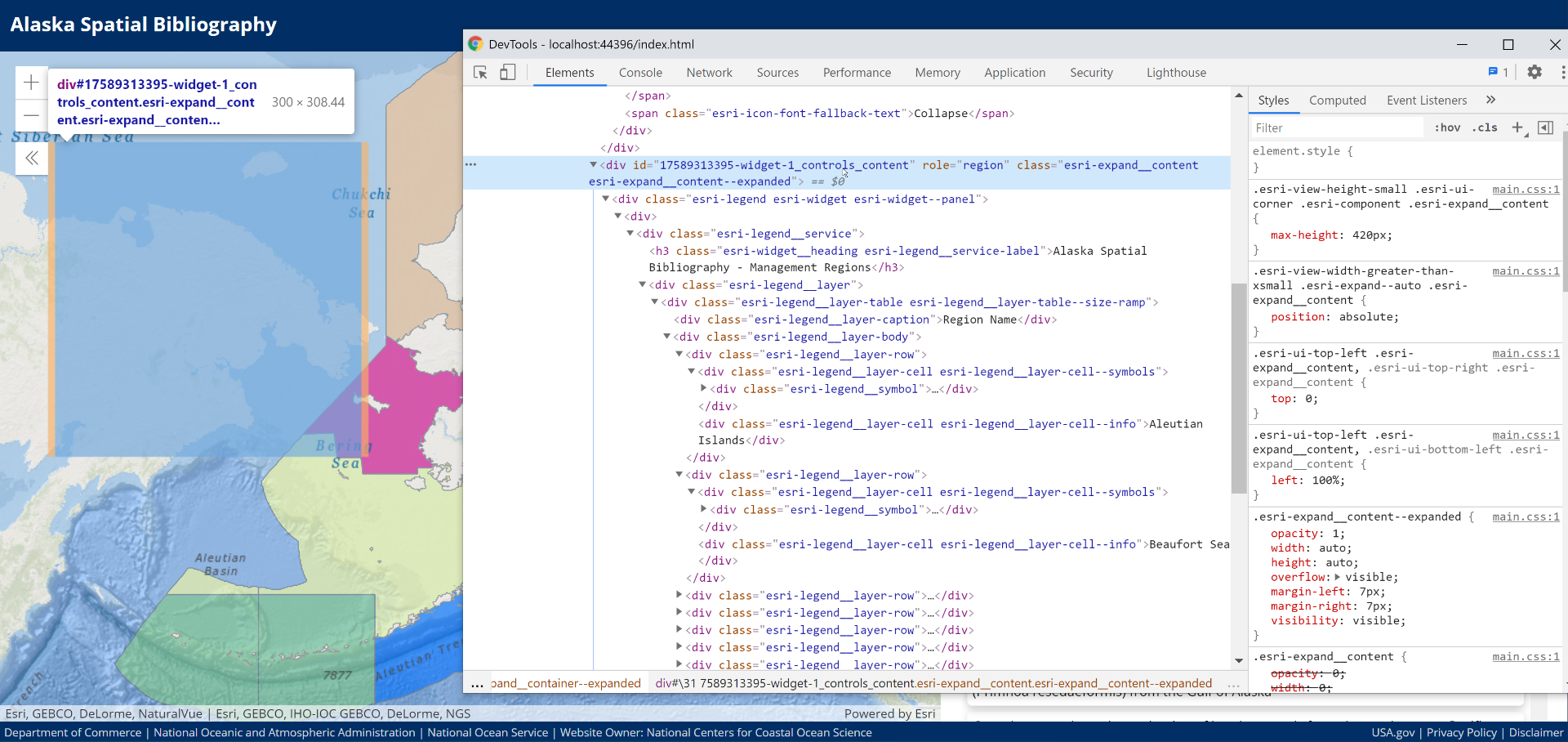

When I add the legend to an Expand widget, it is not showing up. When I explore the element in Development Tools, all of the legend components are there. The legend does show up if I add it directly to the view (line 14). What am I missing?

   Your css rule is way to UN-specific. By having body, * that means everything gets  overflow hidden. You should really be more specific as to what you want to get overflow hidden. For your current css rule you would have to use:
      body, * {
        box-sizing: border-box;
        margin: 0;
        overflow: hidden;
        font-family: 'Open Sans'
      .esri-ui-inner-container * {
        overflow: visible !important;
because the esri ui containers need to have overflow visible and most things under them as well.

I've tracked it down to css, where I have this:
body, * {
  margin: 0;
  overflow: hidden;
It's the overflow line that affects it. But if I comment that out, it does some really weird things to the map
I tried adding
.esri-expand {
but that doesn't make a difference
      body, * {
        margin: 0;
        overflow: hidden;
