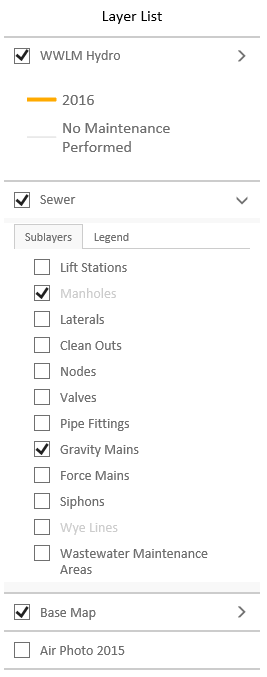

I have an application using the layer list with legend. When the application loads, I am looking to have two of the layers automatically expanded. So far, I can get one to expand on load, but I want another layer. Here is what I have:
The code to accomplish this task is:
// Layers Widget - Choose Child to be Expanded on Load
layerList.on("load", function() {
layerList._layersNode.firstElementChild.className += " esriListExpand";
When the application loads, I am wanting these layers to display like the screenshot below:
I was thinking something like this, but it does not seem to work.
//layerList.on("load", function() {
// layerList._layersNode.secondElementChild.className += " esriListExpand";
Does someone know of another method I can use to have both layers expanded on map load?
Thank you!

Thank you much Robert! Always appreciate your feedback. I found another way to do this:
This block of code also solves the issue. The childNodes have an index number:

// Layers Widget - Choose Child to be Expanded on Load [0] Indexing Number in Order
layerList._layersNode.childNodes[0].className += " esriListExpand";
layerList._layersNode.childNodes[1].className += " esriListExpand";
