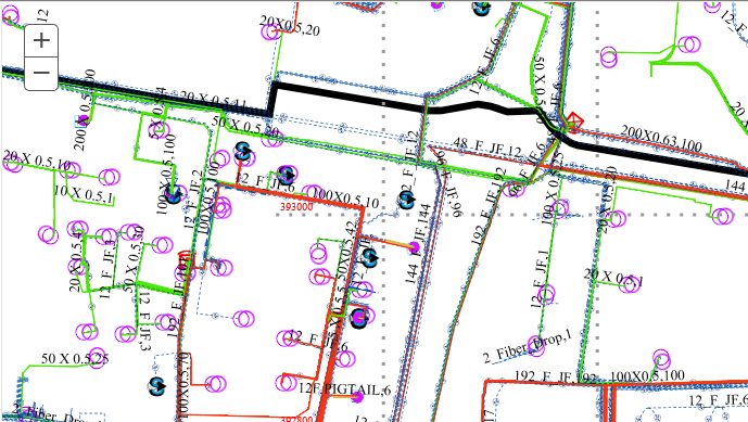

Labels show on the map without issuesHi,
I am trying to print secured services and it works fine for most of the part except that the labeling info does not show on the print output.
While I am preparing the map, the labels do appear, but do not show up on print output.
I am using ESRI JS API v3.25.
