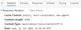

3.7 web app that's been running for a few years now, just recently started having issues with the proxy.ashx. We have the latest .net proxy installed, ver 1.1.2, app/proxy both hosted on IIS 8.5. This is also the same machine running portal/server web adaptors.
When the app starts loading feature tables, the below request fails with: net::ERR_CONTENT_DECODING_FAILED 200 (OK)
https://app.ourdomain.com/proxy/proxy.ashx?https://gis.ourdomain.com/server/rest/services/Hosted/ReviewerDB2/FeatureServer/0/query?f=json&returnIdsOnly=true&token=1...
If I try the request without going through the proxy, everything works as-expected. So ArcGIS server and the hosted datastore are all operating normally. The ArcGIS server logs also display nothing.
