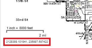

Hello everyone, I added a snippet of code that allows for displaying the coordinates on the map as the cursor moves.  Right now, the existing coordinates are on OK State Plane North Coordinates.  I want to project these coordinates to a WGS 1984 or a Web Mercator (3857) - (see image below and coordinated within red box):

Hello Robert.  I was looking at that widget yesterday and it is really nice, but takes up a little too much real-estate.  I really like what I came up with for the app.  I do want to get this to work, just so I know it can be done.
With that said, I may end up looking at it again and add it as a tool with the measurement widget...perhaps up here (see red box)?
