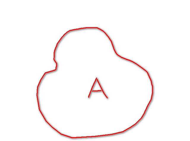

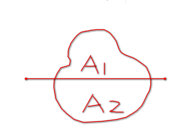

Q1: How can i split a polygon
   now   there is a polygon A,when i draw a line, then the polygon split to two (A1,A2).
                                      pic one
                                                             pic two
Q2:How can i merge serveral polygon to one
   now  there is two  or more than two polygons next (A1,A2) ,when I  press Ctrl key ,then  the polygons all be choiced ,how  can I merge then to one(A)
like the picture up  pic two ------> pic one

You'll need the geometryService:
geometryservice-amd | API Reference | ArcGIS API for JavaScript
This will get you geometries and you can update/create your features for saving as required. Here's how I've done this.
Split:
- Start with a selected polygon (know what you're splitting)
- Use the draw toolbar to get a line (onDrawEnd Event)
- I use the GeometryService->trimExtend to make sure the line will cut completely
- Use geometryService->cut([selectedPoly], newLine, ...) to get two new polys
- save the new polys (add two new and delete old, or whatever works for your data)
Merge
- Select multiple polygons
- geometryService->union([selectedPolys]) to get one poly
- save the new poly (delete the old, add new, etc).
I haven't touched on managing the attributes, but that shouldn't be bad once you have the geometries:
