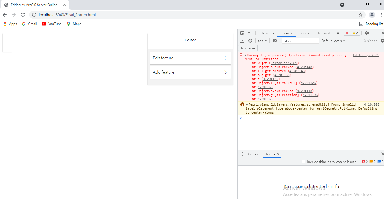

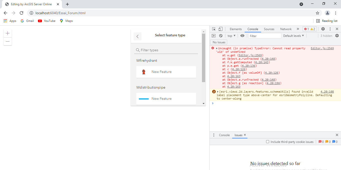

Please, could you guide me , I have a problem with the widget Editor (arcgis-JS-API),
I need to loop through all my featurelayers (in my map), to apply the Editor widget "esri/widgets/Editor", to the layers in my map (uploaded from Arcgis server online), because I need to add (edit, delete, update capibilities to my featurelayers in the same document) : could you please guide me, here you find my code, I have this error message, when I run it
The error message: (you find the screenshots, below, after the code)
Uncaught (in promise) TypeError: Cannot read property 'uid' of undefined
    at w.get (Editor.js:2569)
    at Object.a.runTracked ((index):148)
    at f.k.getComputed ((index):143)
    at p.e.get ((index):136)
    at c ((index):126)
    at Object.f [as valueOf] ((index):126)
    at (index):163
    at c.u [as _notify] ((index):196)
    at c.g.onCommitted ((index):198)
And here the code:

here the screenshots

    require(["esri/widgets/Editor", "esri/layers/FeatureLayer", "esri/views/MapView", "esri/Map"], function(Editor, FeatureLayer, MapView, Map) {
      const wfirehydrantSymbol = {
        type: "simple",
        symbol: {
          type: "picture-marker",
          url: "https://img.icons8.com/doodle/48/000000/fire-hydrant--v1.png",
          width: "20px",
          height: "20px"
      const wfirehydrantPopup = {
        title: "wfirehydrant",
        content: "<br>FID:</br> {FID} <br>z:</br> {z}"
      const wdistributionpipeSymbol = {
        type: "simple",
        symbol: {
          type: "simple-line",
          cap: "round",
          color: [0, 172, 230],
          width: "5px",
          style: "solid"
      const wdistributionpipeLabel = {
        symbol: {
          type: "text",
          color: "black",
          haloColor: "white",
          haloSize: "1.5px",
          font: {
            family: "Noto sans",
            style: "italic",
            weight: "normal"
        labelPlacement: "above-center",
        labelExpressionInfo: {
          expression: "$feature.Shape__Length"
      let wdistributionpipePopup = {
        title: "wdistributionpipe",
        content: "<br>Materal:</br> {MATERIAL_E} <br>CITYENAME:</br> {CITYENAME}"
      let wtransmissionPipeSymbol = {
        type: "simple",
        symbol: {
          cap: "round",
          color: [0, 0, 230],
          width: "5px",
          style: "solid"
      let wtransmissionPipeLabel = {
        symbol: {
          type: "text",
          color: "black",
          haloColor: "white",
          haloSize: "1.5px",
          font: {
            style: "italic",
            weight: "normal"
      let wtransmissionPipePopup = {
        title: "WTransmissionPipe",
      const wtransmissionPipe = new FeatureLayer({
        url: "https://services3.arcgis.com/0G16ZDbXMbWFq4Wr/arcgis/rest/services/wtransmissionpipe/FeatureServer/0",
        popupEnabled: true,
        renderer: wtransmissionPipeSymbol,
        labelingInfo: [wtransmissionPipeLabel],
        popupTemplate: wtransmissionPipePopup
      const wdistributionpipe = new FeatureLayer({
        url: "https://services3.arcgis.com/0G16ZDbXMbWFq4Wr/arcgis/rest/services/wdistributionpipe/FeatureServer/0",
        popupEnabled: true,
        renderer: wdistributionpipeSymbol,
        labelingInfo: [wdistributionpipeLabel],
        popupTemplate: wdistributionpipePopup
      const wfirehydrant = new FeatureLayer({
        url: "https://services3.arcgis.com/0G16ZDbXMbWFq4Wr/arcgis/rest/services/wfirehydrant/FeatureServer/0",
        popupEnabled: true,
        renderer: wfirehydrantSymbol,
        popupTemplate: wfirehydrantPopup
      const map = new Map({
        basemap: "osm",
        layers: [wtransmissionPipe, wdistributionpipe, wfirehydrant]
      const view = new MapView({
        container: "viewview",
        map: map,
        center: [43.902257, 26.38444],
        zoom: 15
      const editor = new Editor({
        view: view,
        snappingOptions: {
          enabled: true,
          selfEnabled: true,
          featureEnabled: true,
          featureSources: [{
              layer: wfirehydrant
              layer: wdistributionpipe
              layer: wtransmissionPipe
      view.ui.add(editor, "top-right");
  </script>
</body>
</html>
