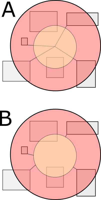

Hi all
I am struggling with how to return a distance from a drawn geometry (polygon, extent, circle) that is buffered (user specified distance) and which then selects any features within that object. At the moment, I get the distance from the centre point of the object (A) and not the edge of the buffer start edge (B). Hopefully the following graphic should illustrate better what I need to calculate:
Here is the code I am using (Version 3.28 api):

Any ideas or suggestions gratefully received!
Thanks in advance,
Mark
KenBuja
MVP Esteemed Contributor
For the distance1 parameter, you're putting in the original geometry that the user drew instead of the buffered feature
distParams.geometry1 = userMP;
