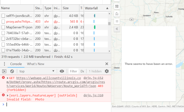

Got the following error on Chrome console. The widget isn't working. Not sure why.

Add the server url tag for that url.
<serverUrl url="https://route.arcgis.com" username="blah" password="blah" rateLimit="600" rateLimitPeriod="60" matchAll="true"/>

  Have you added the route.arcgis.com to your proxy.config?

Here's the content of the config file. How would I do that?
RobertScheitlin__GISP
MVP Emeritus

Thanks, I marked your latest reply as correct. I added the route url as you pointed out. It was still throwing the same error in the Chrome console. On top of that, I had to add two more <serverUrl> tags in the config file to get it to work. One was for my organisation's AGOL account and the other was to ArcGIS REST services url. I had to create a new app at ArcGIS for Developers so that I could obtain a ClientID and ClientSecret. See code from config file below.
<?xml version="1.0" encoding="utf-8" ?>
<ProxyConfig allowedReferers="*"
             mustMatch="true">
    <serverUrls>
        <serverUrl url="https://willcountygis.maps.arcgis.com" username="blabla" password="blabla" rateLimit="600" rateLimitPeriod="60"
                   matchAll="true"/>
                    <serverUrl url="https://route.arcgis.com/" username="blabla" password="blabla" rateLimit="600" rateLimitPeriod="60"
                   matchAll="true"/>
                   <serverUrl url="https://services.arcgis.com/" clientid="blabla" clientSecret="blabla" rateLimit="600" rateLimitPeriod="60"
                   matchAll="true"/>
    </serverUrls>
</ProxyConfig>‍‍‍‍‍‍‍‍‍‍‍‍‍‍‍‍‍‍‍‍‍‍‍‍‍‍‍‍‍‍‍‍‍‍‍‍
