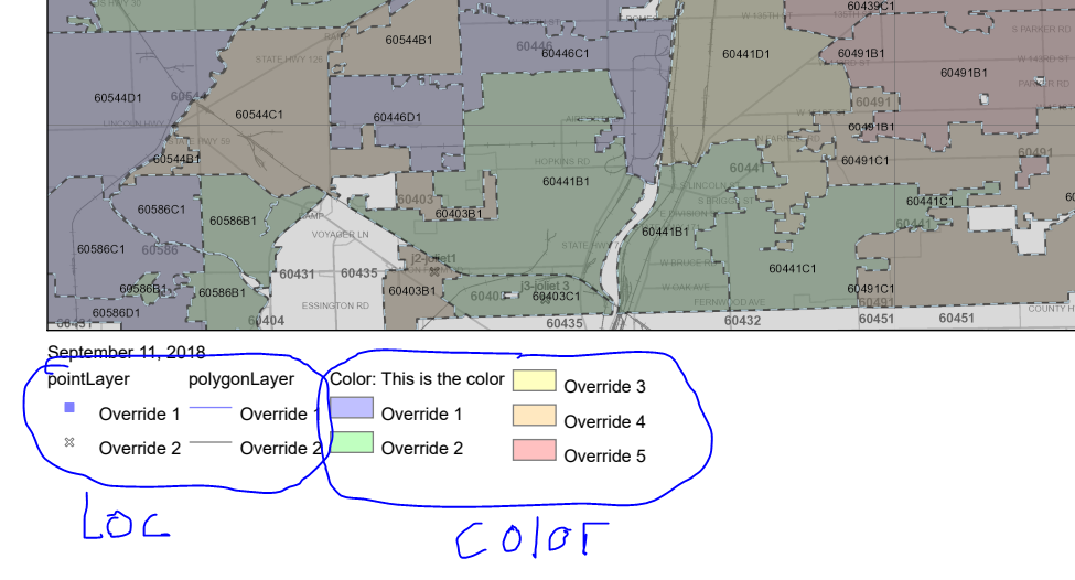

The layers come out on the map. I then use the PrintTask to allow a user to print the map. I want to customize the Legend so the user knows exactly what is on the map. I use the LegendLayer to tell what layers to show but I do know know how to customize the description that comes out for the Graphics/Features that are displayed. I can customize the title of the actual layer but the individual graphics I don't know how to. They system shows some default values. How can I change those descriptions.

It seems as my overlays are still coming up correctly. When I try to print I am getting the following error:
a.renderer.toJSON is not a function
