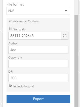

I have Custom Text Elements in my print template that works great when using WAB. The Custom fields show up when you click the print widget and gives you a chance to fill them out and it prints out correctly. When I click the print widget using JavaScript 4.13 it doesn't show the text boxes to fill out. Should it? If not, how do I go about making this happen? Is there an an example that I could use? Thanks!
JavaScript snapshot:
WAB snapshot:
Here is my code that I'm using for the print widget:

   No the 4.13 Print widget does not have builtin UI support for custom elements in print templates. To get this working you need to find the print services layout custom elements and add those to the advanced section of the widget. Borrowing some code from the WAB print I was able to come up with this modified sample. Just replace the print service url with one that has custom elements to see this work.

JasonDavenport
Thanks! I have it working... except it prints the custom elements once. If I print again or click on the Map Only tab and click back, they do not show up on the print. Your thoughts?
