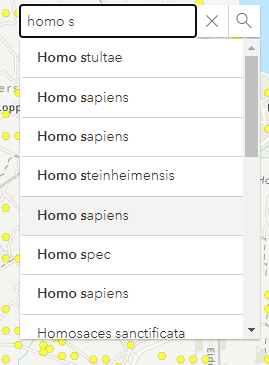

Hello people,
I am looking for a way to search for a scientific species name and receiving the data from the GBIF api.
Now I have already implemented auto completion if I search for a scientific name, but selecting the name in the search-widget doesn't parse the result to getResults object.
Is there any way to fix this?

I realized I was looking at the properties of Layersource so I deleted my previous suggestion of using displayName.
Using your code in a code pen, I think you need to change a few parameters.
key: "species",
text: feature.species,
sourceIndex: feature.speciesKey
This doesn't produce the not found error, and keeps the typed value and watching the example, the selected name gets populated only after the subsequent query runs.  To get the selection to populate the box, I think you will need to work out your getResults code and return the object.
