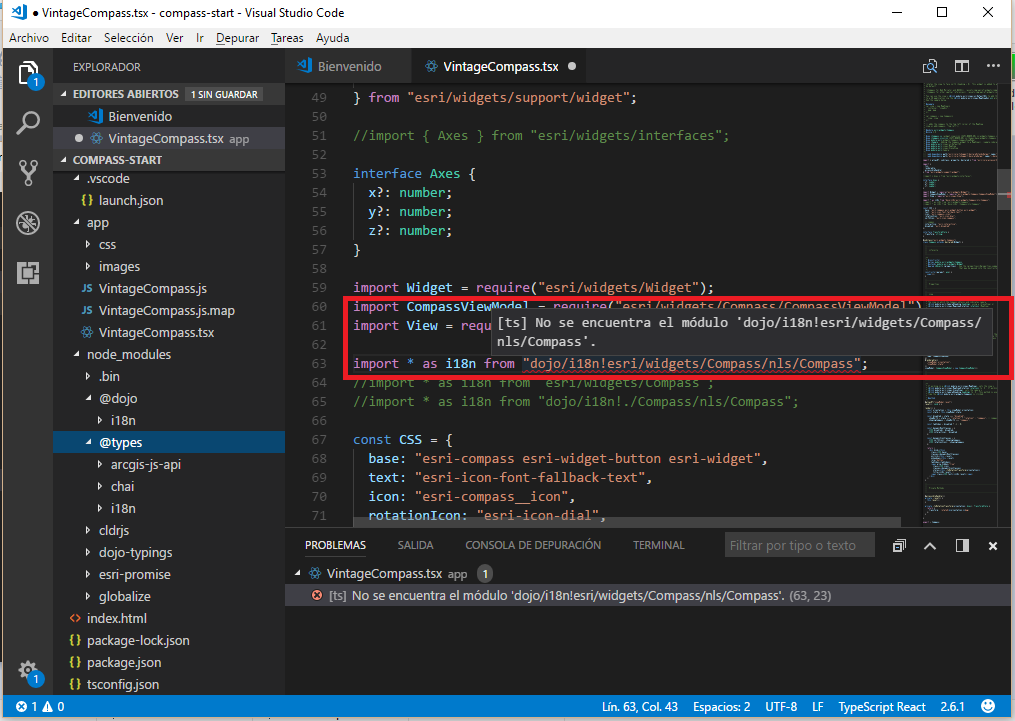

But it is not possible to use (compile or run) the Compass Widget, because I have this error in my Visual Studio Code editor:
Cannot find module 'dojo/i18n!esri/widgets/Compass/nls/Compass'.
[ts] No se encuentra el módulo 'dojo/i18n!esri/widgets/Compass/nls/Compass'.
I followed the steps provided:
dev-summit-2017-customizing-widgets/compass.md at master · jcfranco/dev-summit-2017-customizing-widg...
I tried to change the paths, but I think there is a problem with the Typings of dojo. I ran the previous steps to configure the Widget Folder:
I created the package.json: npm init --yes
I installed Dojo Typings: npm install dojo-typings --save-dev
I installed typings for JASAPI ArcGis: npm install --save @types/arcgis-js-api
I created the config.json
As you can see in the image, I tried to install i18n and its typing .. but nothing, the same problem!
i18n load error in the Compass Widget code
How can I fix the access to dojo/i18n module?

I, too, have this issue.  The weird thing is that the type script will transpile into workable javascript artifacts, but this causes build failures due to the type script compiling errors.  I added the typings and api through npm as per the instructions.  Any ideas?

If you haven't had a response yet.
Add the files in the tsconfig.json. It fixed my issue. My application-base-js is in a custom folder at the moment due to a code base issue with npm
"include": [
"./src/**/*"
"exclude": [
"./node_modules",
"./tsrules"
"files": [
"./node_modules/@types/arcgis-js-api/index.d.ts",
"./node_modules/dojo-typings/dojo/1.11/loader.d.ts",
"./node_modules/dojo-typings/dojo/1.11/index.d.ts",
"./node_modules/dojo-typings/dojo/1.11/modules.d.ts",
"./node_modules/dojo-typings/dijit/1.11/index.d.ts",
"./node_modules/dojo-typings/dijit/1.11/modules.d.ts",
"./node_modules/dojo-typings/dojox/1.11/index.d.ts",
"./node_modules/dojo-typings/dojox/1.11/modules.d.ts",
"./src/libs/@esri/application-base-js/support/updates.d.ts",
"./src/libs/@esri/application-base-js/index.d.ts",
"./src/libs/@esri/application-base-js/interfaces.d.ts"
