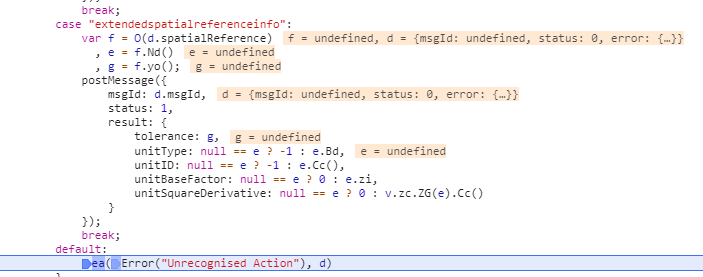

The problem is that the "esri/geometry/geometryenginewebworker.js" listens to this message as well and do a switch case according to the message sent (case "equals", "disjoint", "within", ...).
Of course, as it is not concerned by this message, it goes to the default case which itself post another message "Unrecognised Action" and there we go, we run into infiinite loop :
Can it be fixed please ? Any worker around that come to your mind ?
