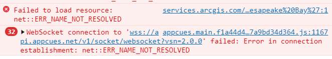

(2) In the browser console, I also notice I am receiving the following errors:
It seems to be related to the feature service I'm using, but I'm not sure why this is occurring as the features are appearing and functioning within the app.
