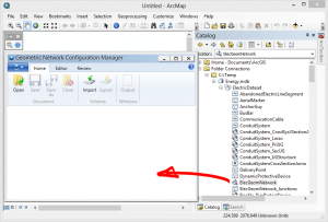

Following the successful installation of the add-in.  Display the Geometric Network Tools toolbar and click the first button to launch the main dialog.  Drag and drop a geometric network into the configuration manager window.Capture3-300x203.png

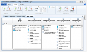

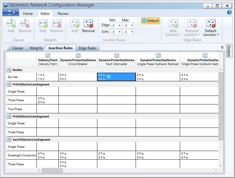

The complete definition of the geometric network will be loaded into the dialog.  The four tabs below the ribbon make it is possible to review and, in some cases, modify classes, weights and connectivity rules.Capture5-300x180.png

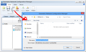

The geometric network definition is current stored in memory and should really be saved to a file so that it can backed-up or restored at a later time.  Click the save or Save As button to export the definition to a file with a esriGeoNet extension.Capture6-300x180.png
Recreating a geometric network is just a matter of loading an esriGeoNet file and clicking Export.  The application will prompt the user for the name and location of the exported geometric network.  If the geometric network already exists, it will be overwritten.Known Issues:

Hi, thanks for creating this necessary tool.
Has anyone been able to use the "Remove" Classes tool in the Editor tab?
I've tried it after opening just the .esriGeoNet file and after importing a Geometric Network from my GDB. This tool always seems to be grayed out. I need to remove 2 feature classes that have been retired from the configuration schema. I am not able to recreate the Geometric Network unless I recreate these missing feature classes in the feature dataset. And even after that I am not able to remove them.
