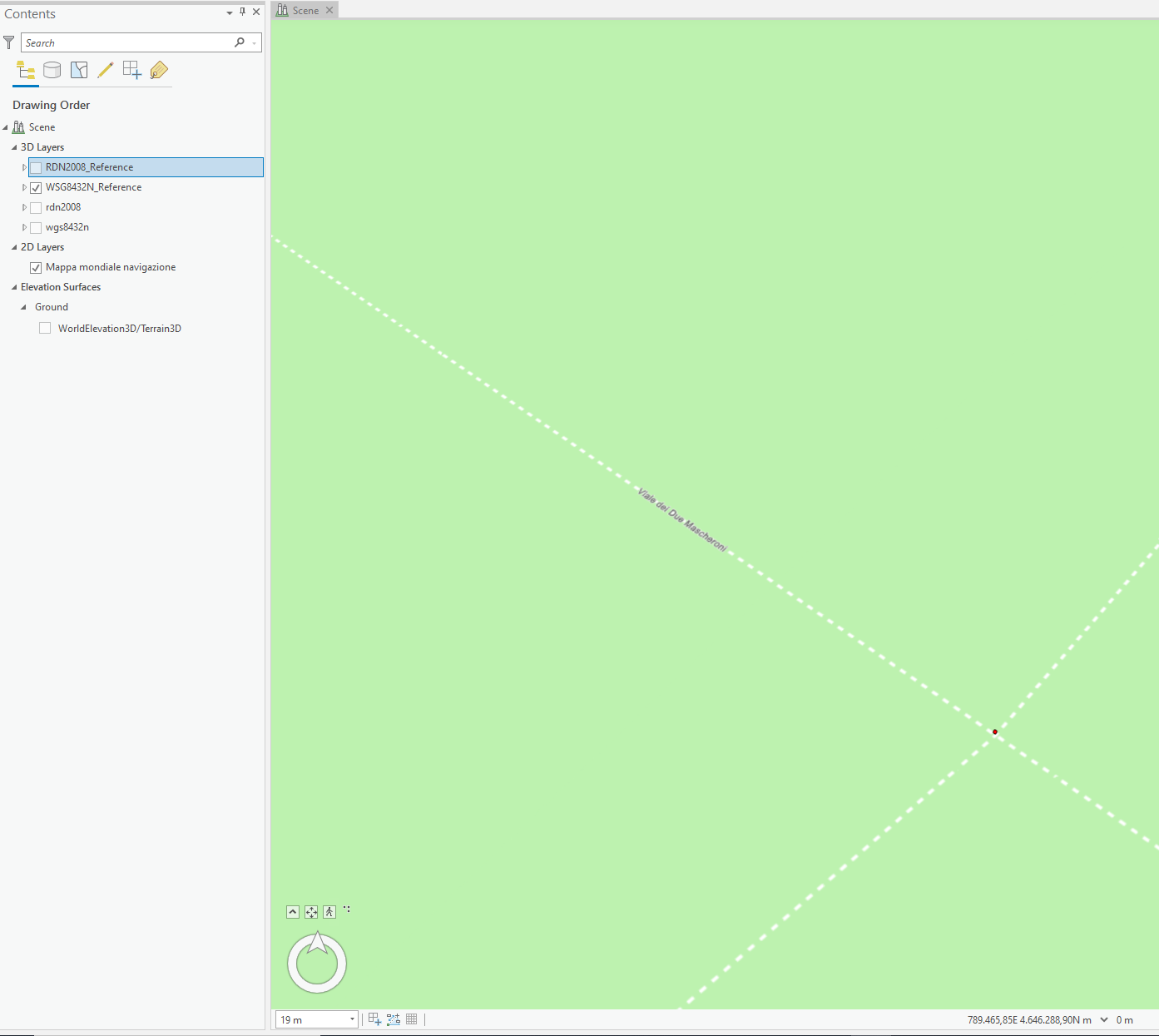

Reference point in WGS84 UTM 32 Nord
789471.0512163E
4646281.7997445N m

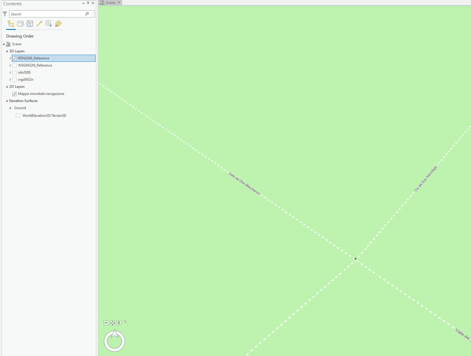

Reference point in RDN2008 Italy Zone
7040625.3072000 E
4635397.4217000 N m

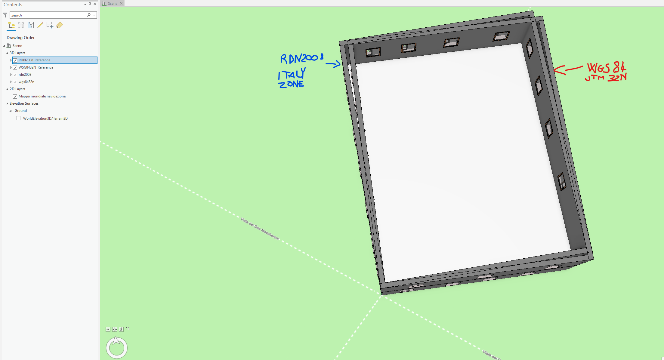

When I place on the Scene my two file IFC I have a kind of rotation between the two files, but the starting point is identical.
The basemap in my scene has WGS84 UTM 32 Nord coordinate system and I have the stranger behaviour that I have described before.
Someone kwow why I have this kind of rotation?
