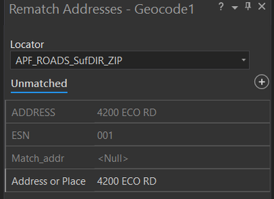

@ShanaBritt found this thread as to being as close to the issue I am seeing for the first time trying to Rematch Addresses. In the past, the Rematch window would allow the user to correct the address or, in our case ESN instead of Zip Code, and now the ESN option is not available to change, which is what I need to do. See snapshot below. I am using 2.9.3 and have been with Rematch. Auto Apply is checked. No help regardless on using Predefined Queries or not. This is a first so I am dead in the water.

@GeorgeBrown1 When geocoding the table which Output Fields option did you select in the Optional Parameters section of the Geocode Addresses tool or Geocode Table tool?
GeorgeBrown1
Hey @ShanaBritt ,
For the Output Fields I leave as default, All.
So I am still having the same issue with 3.1.3, below screen shot. I have tried saving the output to a shapefile, not supported, the project FGDB as a FC, no luck, creating a new FGDB and saving as a FC there, with no luck. I have pointed the 'Locator', within the Rematch Addresses window to the exact locator used to geocode the spreadsheet, no luck. I have played with the fields under the 'Select Fields' options, no luck. This is twice now, where I am unable to run the Rematch Addresses tool on a geocoded file in two different Pro projects.
