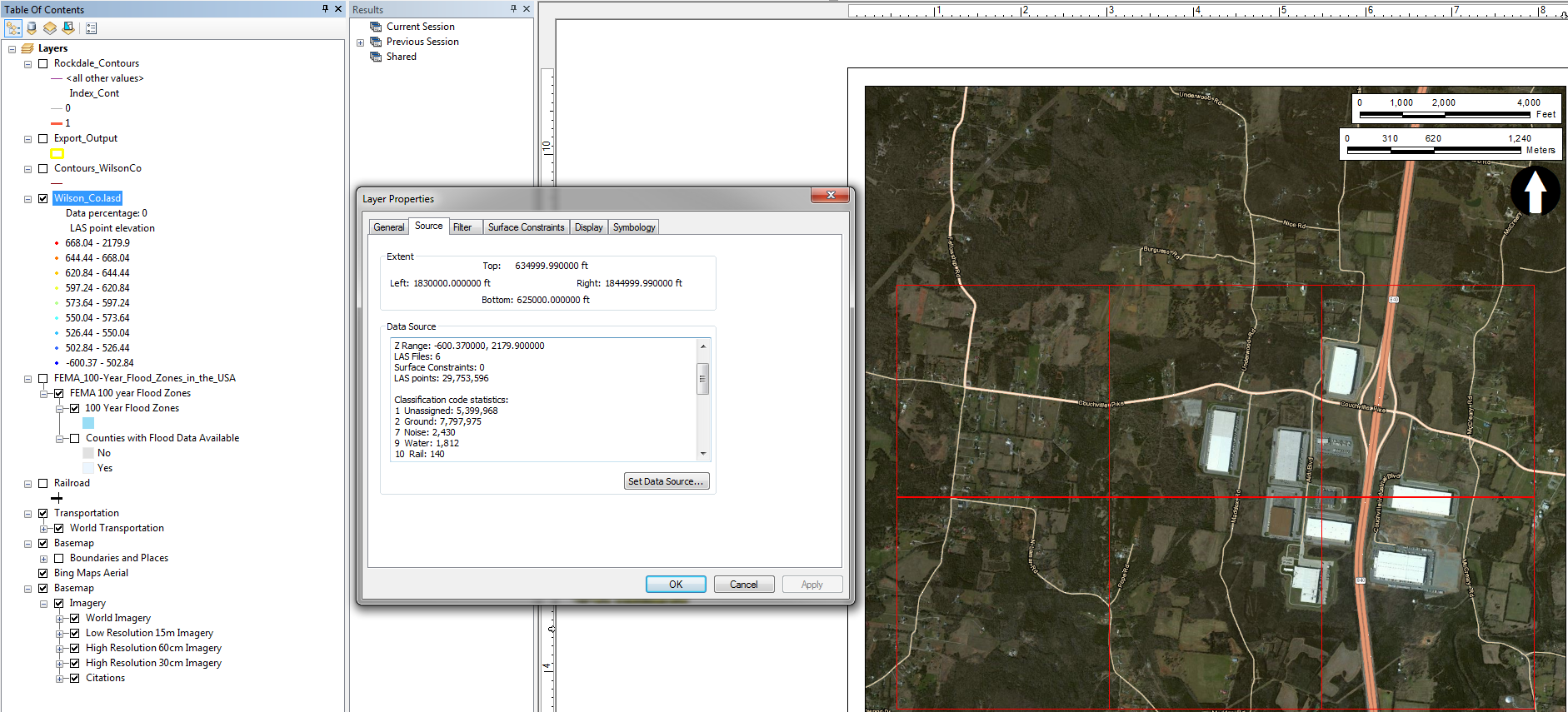

Here is a screenshot for what mine looks like.  Can you check your layer properties and see how many points the dataset says it has?
Also when you created your LAS Dataset, what was your process for creating it?  I usually create an empty LAS Dataset in the Catalog, then add my .las file to them(Add Files to LAS Dataset Too)l, instead of adding them when I create my LAS Dataset.

My dataset has 12,350,993 points in total. I made it in ArcMap using the Create LAS Dataset tool.

Have you tried zooming into to smaller area?  In my first example it showed no points because I was zoomed out to far, if you zoom in it will usually show start showing some of your points.  If the points are truly in the dataset, then you should be able to create a DSM from them, even if the points aren't showing on the display.
