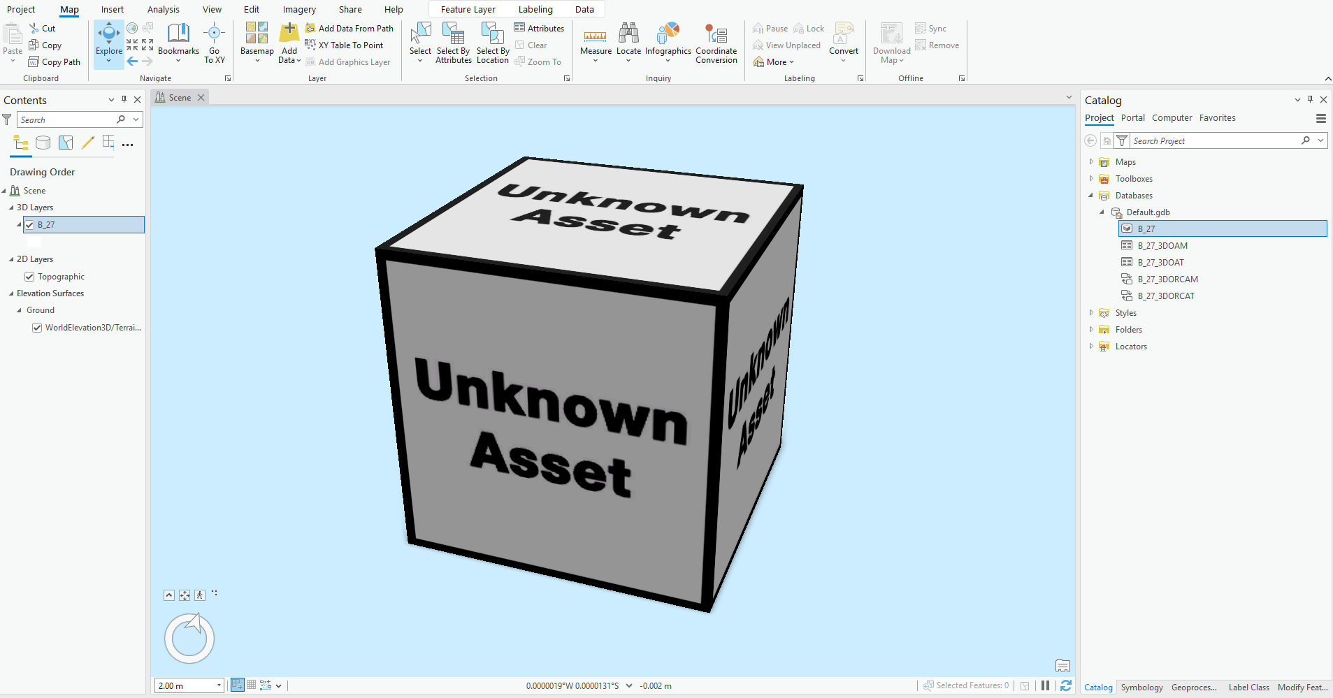

Hi there,
I’m trying to import a 3D file in .obj format using the Import 3D Files tool. For files under 2GB, the tool works fine and generates an output. However, when the file size exceeds 2GB, I encounter the error message: "050038: No Valid Files." I also tried using the Import 3D Objects tool to perform the conversion, and while it generates an output, the resulting file has an unknown asset label.
 Thank you for your advice, I truly appreciate it.

Kit_YengLo2
Hi there,
