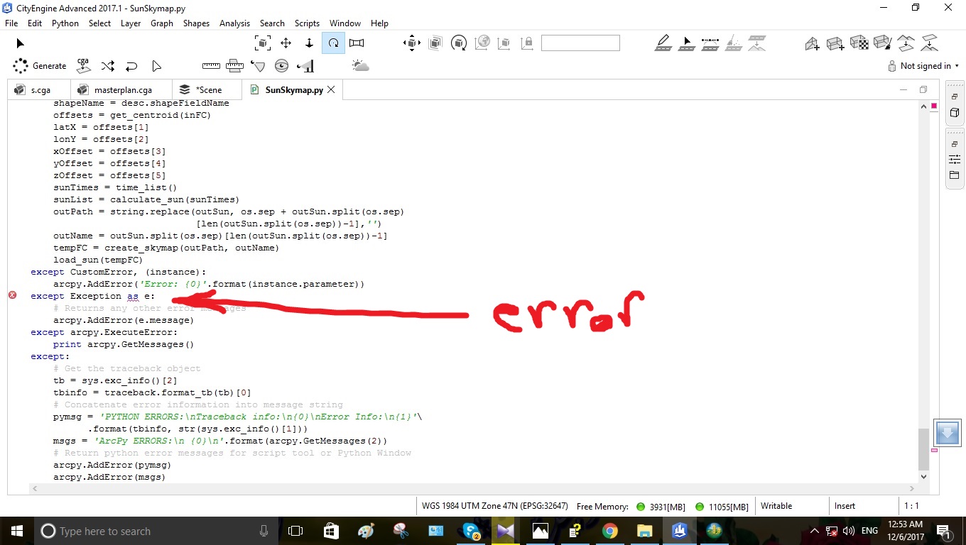

maziyaryousefi
hi  Kduri -esristaff - I think the Python code has a problem -Attach the corresponding image
DanPatterson_Retired
MVP Emeritus
If cityengine is using python 3.x, then that may be due to differences between try except error raising between python 2 and 3
