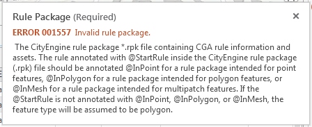

I am trying to run a CityEngine rule package in ArcPro using the "features from city engine rules" tool. I know the rule package works because I have used it before in CE. Now that I am trying to run it in ArcPro, I am getting an error message.  See image.  I am not a cga programmer and I am new to most of this.  Any advice would be appreciated.

First question is do you have the source CGA? If not, then is the RPK locked? If the RPK is unlocked you can get the source. You'll need to put a change in the CGA using CityEngine.
Second question is what kind of geometry is your feature layer? What the error message is saying is you need to tell the RPK what kind of geometry it is expecting (this is not needed when run in CE). The only geometries supported for RPKs are Point, Polygon, and Multipatch. Polylines are not supported.
So if you have the source CGA, you'll need to add one of the annotations listed in your error message shown above. For Example, if your features are Polygon, then your start rule would need the @InPolygon added like below:
@StartRule @InPolygon
YourStartRuleName -->
   extrude(123)   # extrudes polygon by 123 meters.
