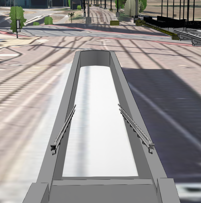

Hello, I need your help. I'm currently integrating BIM models (Revit) into my AGOL. However, I haven't been able to adjust the DEM so that it includes underpasses and structures that are located below the actual ground surface – in these areas, the DEM still appears (see screenshot). Does anyone have an idea on how I should proceed? Thank you and best regards.

The video shows the workflow to create the modified terrain on Pro. After the terrain has been created you can published to AGOL.

Thank you for your help. I try to automate this process with Python to work with multiple files. I could manage to automate the extraction of the Floors, the creation and the merging of the .tif's. But till now, I couldn't automate the step where we define the .tif as Elevation Layer and publish it to ArcGIS Online. Do you have an idea how this could work?
