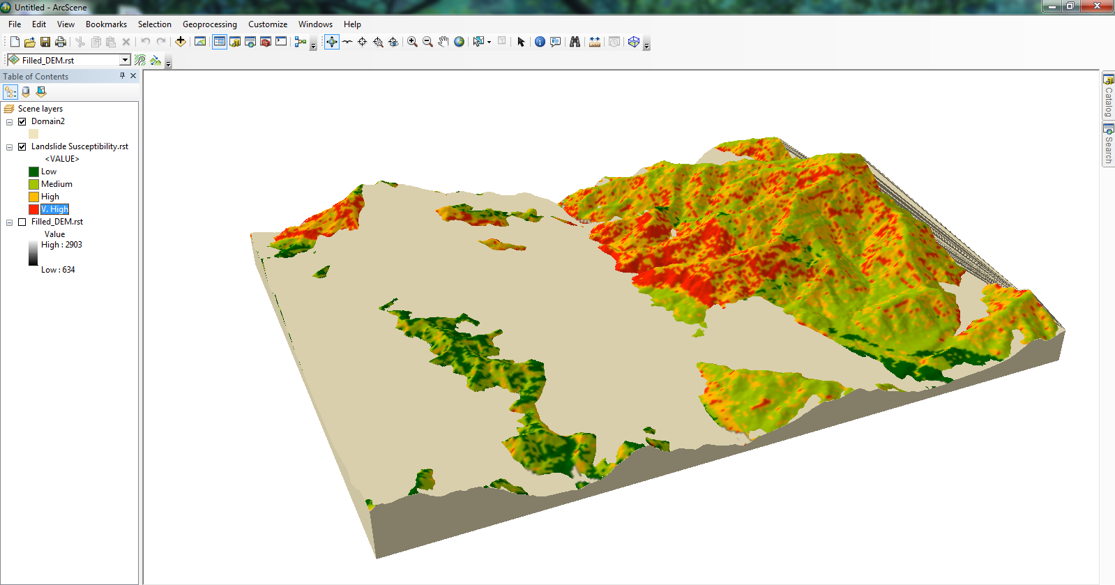

Thanks, Dan I resolved the problem!
The help was helpful:-) This works but requires much attention.

NasirHameed
Dear Adrian,
I simply converted my polygon (Raster Domain) to polylines using 'Polygon to Line' tool available in Data Management toolbox
2. In polyline properties, check 'extrude features' and set 'using it as a value that features are extruded to'
3. in the Base Heights Tab, set base height 'floating on a custom surface' and choose the DEM as input
I have inserted following scree shots also that would help you to do the job.
