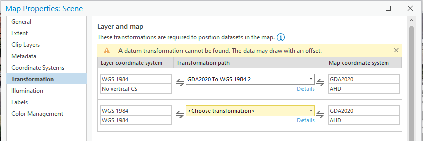

I cannot get Cesium Tiles to display without issue in a local scene in ArcGIS Pro.
  1. Cesium Tiles layers are read in (erroneously) as "WGS84/WGS84" as the horizontal/vertical CRS pair.
  2. Under the Transformations tab of the Map Properties: Scene dialog box, ArcGIS displays a warning stating "A datum transformation cannot be found. The data may draw with an offset." See screenshot below (the relevant row is the second one). Unfortunately, the dropdown box of available transformation pathways remains empty. I'm seeing an offset for sure, but it is difficult to tell if this is a dataset error or a software error.
How can I go about confidently setting this transform pathway? All the pieces seem to be defined somewhere within ArcGIS's Projection Engine but ArcGIS seems reluctant to let me use them.
Ultimately, the pathway required is GDA2020 Cartesian Geocentric (7842/7842) -> GDA2020 MGA5X AHD (785X/5711). And it needs to be set in such a way that I can apply it to these layers erroneously considered to be in WGS84 Ensemble Cartesian Geocentric. I've tried messing about with the Create Custom Transformations tools, but to little avail.
Edit: It might not be the pathway stated above. When I look at the layer properties, ArcGIS Pro seems to interpret them as 4326/115700 which I know is impossible as geographic coordinates are not supported by the file format itself. It is unclear whether this is a display error or the first part of the transformation is automatic, changing the starting point of the required transformation.
Thanks in advance.
