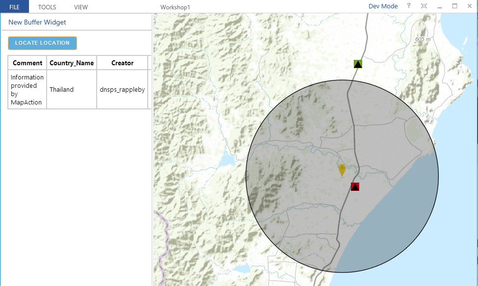

Hi, I make custom widget with Javascript that has simple workflow like below.
1. User select datasouce and field that they want to display
2. User locate location to draw buffer and query selected DataSource with that buffer's geometry to find feature and list them to table.
Well, It's work fine in desktop Application.
But when I test it on browser.

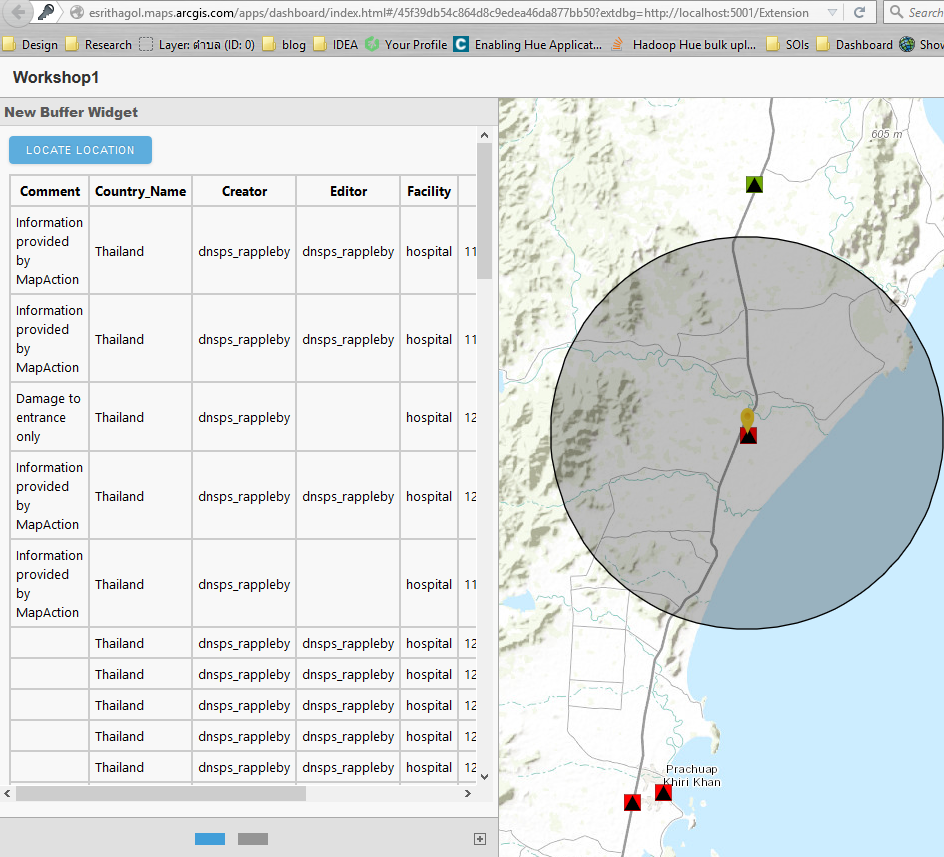

I got different results here with the same widget.
It list all feature of selected DataSource to table.

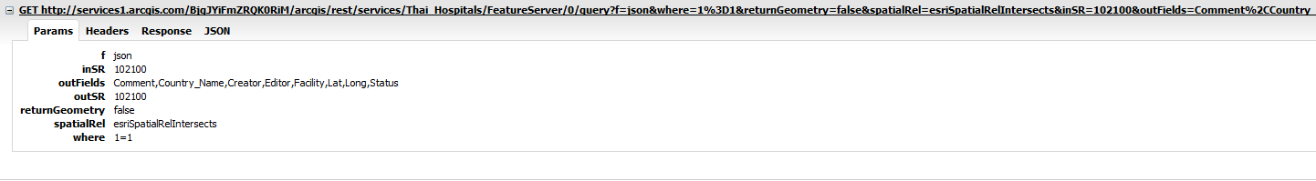

So, I inspect query that fire out.
and found that geometry's param was ignore in browser so it return all of feature back.

Thanks for sending in the sample. I am able to reproduce this problem using my own data, and it seems to be a bug in our API. I noticed that when this.dataSourceProxy.executeQuery(this.query) is called, the buffer's geometry is already dropped from the params of the request, which possibly explains why all features are returned. I have logged a bug into our system and will work with our developers on this.
