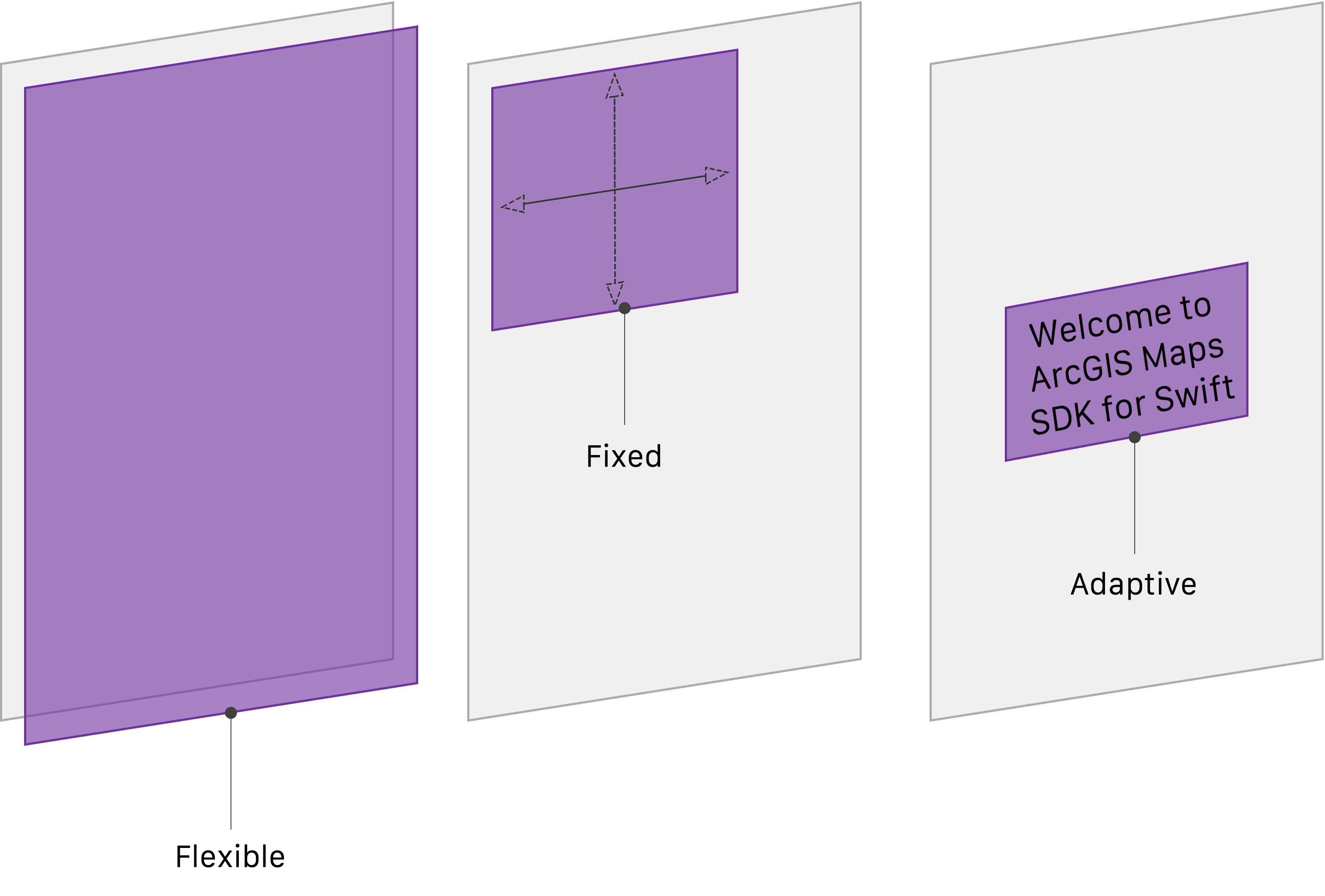

In the section above, we put a MapView in the body. By default, the view is centered. In terms of sizing, there are 3 typical sizes for a view:
- Flexible: The view tries to take up as much space as it can on the screen. Think of a rectangle Shape. The MapView falls in this category.
- Fixed: The view has a fixed frame, such as an image, or a view with specified fixed frame.
- Adaptive: Depending on its content, the view negotiates its size with its neighbors. Think of a Text, whose size is influenced by font, line break, line spacing, word wrapping, etc. ArcGIS callout on a map view is an example.
Wireframe showing the basic layout concepts in SwiftUITo construct your custom view layout, use the HStack, VStack and ZStack layout containers. These are more powerful than the UIStackView and allow you to group collections of views horizontally, vertically, or stacked on top of each other. They are the building blocks that you can put inside other container views, such as List and ScrollView. These three kinds of stacks, with their alignment and spacing properties, view modifiers, and Spacer views, allow extensive layout flexibility.
