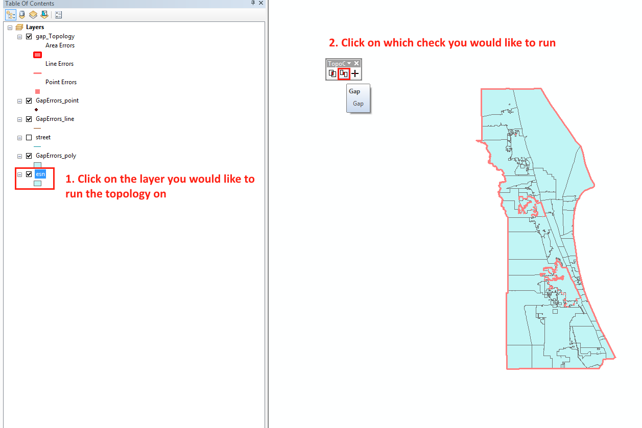

ArcGIS Desktop Standard<\/SPAN> 10.3.1 of latere versies<\/P><\/P>Zo werkt het:<\/P>1. Je downloadt de add-in
2. Dubbelklik erop en installeer het.<\/P>
3. Open een MXD en voeg een polygonlaag en een straatlaag toe.<\/P>
4. De werkbalk zou er moeten zijn, maar als dat niet zo is klik dan op Aanpassen -> Werkbalken -> TopoCheck<\/P>
5. Volg de stappen in de screenshot!<\/P>

Got some results this time. When run, the tools chug away and the classic "Not Responding" shows up, but then it finishes out after several seconds.
Tool runs:
Check for Overlaps - worked when run on parcels with an intentional overlap. Looks good.
Check for Gaps - no results for output feature class GapErrors_poly when run on parcels with gaps, but did get the parcels gaps correctly depicted as lines in GapErrors_line output (purple lines below).
Check Line Segments - DangleErrors output correctly found two dangles that were close to other lines, but missed dangles that were far from other lines. Could be a just be a tolerance setting, though.
Unfortunately, no results for OverlapErrors_line output despite the intentional addition of line overlaps to the street test data.
Note - I made some assumptions when running these, which may influence the results:
1. The tools ran without being in Editing Mode for the selected feature class, which I assume is OK. If instead it is assumed that the user is in Editing Mode for the feature class being checked, let us know.
2. I didn't worry about whether the layers selected to run a tool on were set as specifically Selectable.
3. Ran the tools on test feature classes in a File Geodatabase. Did not try them on Versioned data.
Also, the bane of all software development, a feature request Is there a way to change the default location the output feature classes get written to? At the moment the seem to be going to a new geodatabase added to the C: drive. Not a critical request, but it would be nice to be able to save it to a few levels further out in the C: drive.

Installed the new tool and ran it. Some tools ran fine, others had issues. Some of this may be due to the older version of ArcGIS used.
Here's the results on test data in a File Geodatabase using ArcGIS Desktop 10.2.1:
Check for Overlaps function:
- overlap_polys output correctly identified polygon overlaps in a parcel test dataset.
- overlap_Topology output also found the issues correctly.
- OverlapErrors_point and OverlapErros_line outputs had no results (they showed up in the Table of Contents, but I'm not sure if they are used as part of the "Check for Overlaps" function.
Check for Gaps function:
- GapErrors_poly output was empty/did not find the gaps in a parcel test dataset.
- gap_Topology output did find the gaps correctly.
- GapErrors_point output was an empty table/did not find gaps.
- GapErrors_line found all the gap issues and output them as lines.
Check Line Segment Dangle function:
- YourDangleErrors output correctly found dangles at distances of 0.1 foot and 1 foot in street centerline test dataset. Did not 4 other Dangles present (35'+).
Check Line Segments Overlap function:
- intersect_Topology output correctly showed overlapping lines when run on a test street dataset.
- IntersectErrors_point output was an empty table/did not find overlap.
- IntersectErrors_line output did find the overlaps.
- IntersectionErrors_poly output was an empty table/did not find overlaps. Also, I'm curious as to how this output would be used?
Scratch Workspace function:
- Works. I was able to switch the folder location for the Scratch workspace and the other functions then output the results there.

You can find the latest version here: https://community.esri.com/docs/DOC-9983-topology-check-python-addin
Anybody who wants to test out the newest feature? https://www.dropbox.com/s/i6w2e8dg2d9zygt/TopoAddIn.esriaddin?dl=0
I added a check where you can select a line and polygon feature, and make sure that the line segments break at polygon borders.
Tim- glad to see you've survived the hurricane season thus far!!!!
Yes, I had to work at our EOC, since we are part of Emergency Management and now I am damage assessment mapping.
I figured you were really busy, and still are. Could be a great presentation at next years' UC....
All the best!
Is there a users guide for this somewhere? I'm trying to figure out why the tool is giving me gaps around the borders of my district layers...
There is always a 'gap' to the outside of a polygon feature class when you create a topology. Literally, that's what it is, although it's pretty pointless at the same time....
Hah and I thought I had too much caffeine or something.
I'm glad Joe was able to clear this up.
The download here https://community.esri.com/docs/DOC-9983-topology-check-python-addin includes a readme file.
