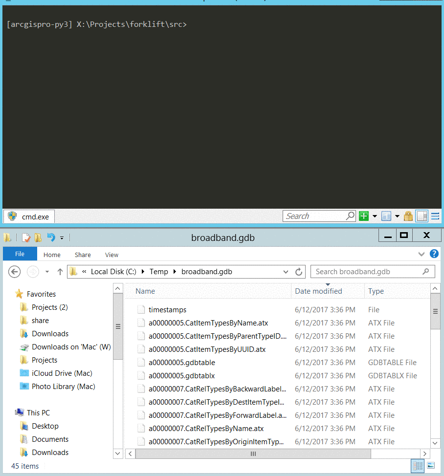

I'm having trouble removing a schema lock from a feature class in a file geodatabase after running arcpy.MakeFeatureLayer(). The typical arcpy.Delete(layer) isn't working.
I only experience this issue when running this with Pro's (1.4.1) version of python. It works fine with ArcGIS Desktop. Any ideas?
Here's a script that demonstrates the issue:
