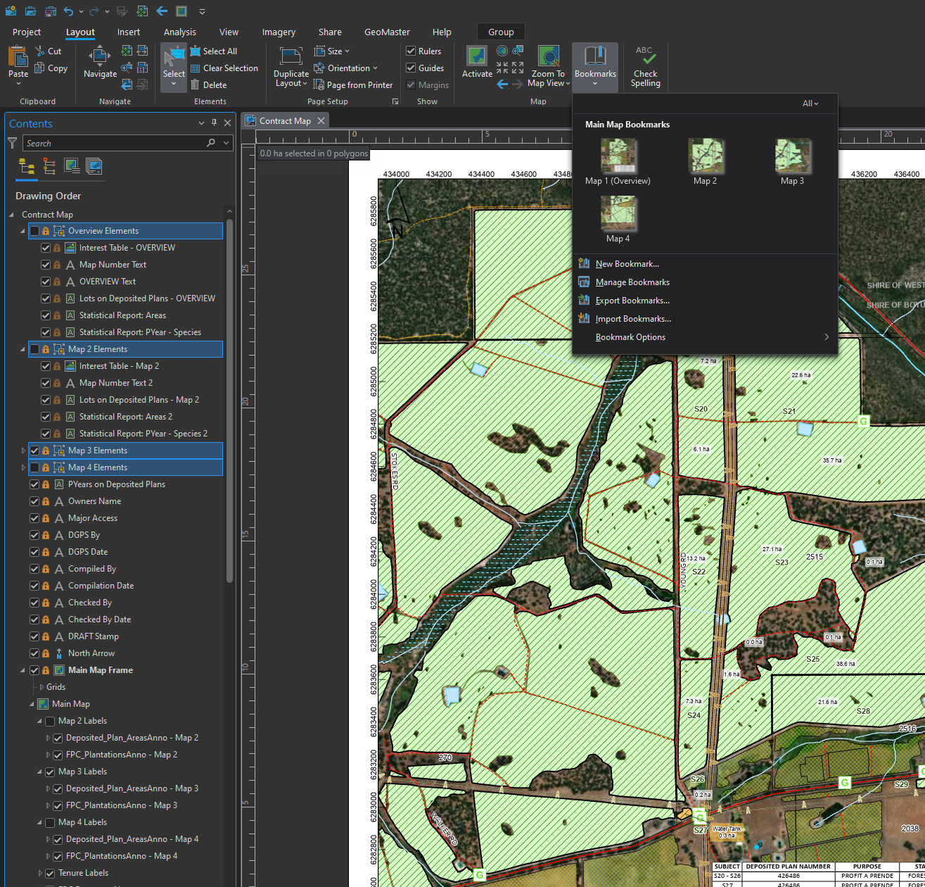

I see this working by having a list of checkboxes on a new section of the Element Pane where you can enable Bookmark Linking and set which Bookmarks would make an Element (or group of elements) visible when navigating to the Bookmark. Elements would be turned off when a non-checked Bookmark is selected. Manually moving/changing the map extent would have no further effect.

I have a layout and am using a series of Bookmarks to focus on different views of a property - an Overview and then 3 Focus maps with more detail. I have Elements in the layout including Statistic boxes (static text as Dynamic text couldn't break down the figures with enough granularity) and other information (i.e. Layout titles, land tenure summaries and locality labels).
You can see in the screenshots below the grouped elements that I turn on and off to suit each Bookmark.
