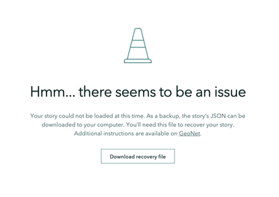

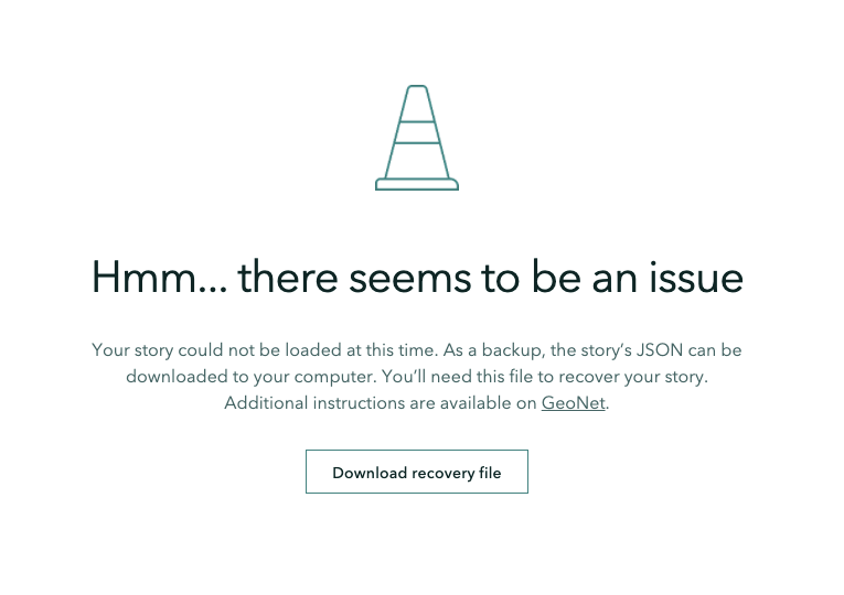

If you've found yourself here, you've had the unfortunate experience of not being able to edit a StoryMap you've been working on. We apologize you're run into this issue, but you can follow the instructions below to recover your story, collection, or theme.
This process requires the ability to run notebooks. If your account does not have this ability, please use the other set of instructions at the bottom of this post
  1. Click on “Download recovery file” link to download the JSON file for your story.

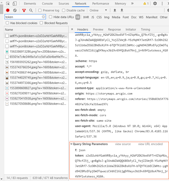

   8.Get the token id by opening Developer tools in your browser, go to Network tab and search for token or draft.json in the filter.

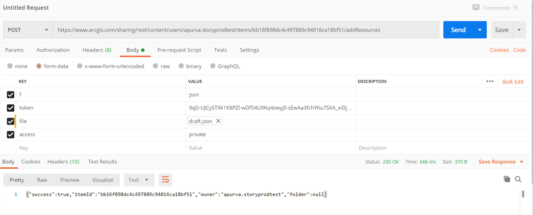

10. Change the request type to “POST” in the dropdown, and enter the following URL:
https://www.arcgis.com/sharing/rest/content/users/<username>/items/<storyid>/addResources
11. Replace <username> in the URL with your user name as mentioned in Step 6, <storyid> with your story id as mentioned in Step 7.

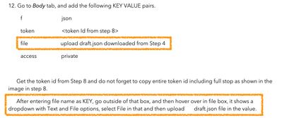

12. Go to Body tab, and add the following KEY VALUE pairs.
         f                             json
         token                    <token Id from step 8>
         file                        upload draft.json downloaded from Step 4
         access                  private
      Get the token id from Step 8 and do not forget to copy entire token id including full stop as shown in the image in step 8.
      After entering file name as KEY, go outside of that box, and then hover over in file box, it shows a dropdown with Text and File options, select File in that and then upload       draft.json file in the value.
 13. Click on ‘Send’.
 14. If you see “Success” message in the console as shown in the image in Step 10, then your story is recovered successfully and on reloading the tab, you should see last saved contents.

Hi -  I have the newest version of Edge.  I found the token under the payload tab and this is what I am copying:
f: json
token: De4URatlqKOOWwfz5glzh6ihkszN3FcdQzcgXdzwXAdV87BY90JFH4Y3dKfQEuBn5T81W9bnnW_xO-HluZ_fa2JMR2FXwoBLSS1A5MsnXjzp4zZNiJmo2Lla2ocFOx0OGpbALXhm6EhlvMD9TY0xJ7TkfpcoaKNh6c73KfuOtr-dmPAaz31f8BBCJw26dNYDPOgcOL4FqVWQBB_xMOwUuK4qmo9T0v5Dp2tRrM0jn9oPeWVIxwXOySyzOeeUujUX
Here is my error message:
"error": {
        "code"498,
        "message""Invalid token.",
        "details": []
What am I not copying correctly for the token?
Thanks!
AravindatStoryMaps
Hi @StephaniePhillips-MG sorry for the delay in reaching out. It might be possible that
you're missing a ' . ' at the end of the token. Sometimes that period (dot) is necessary and part of the token value in order to make these requests.
Please let me know if you're able to do this for the new token you see today. If you're still running into errors, i can reach out to you to help assist you with this problem.

@Anonymous User - The instructions to upload the draft file are in step 12 in the blog post above. 

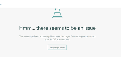

Hello! I am a teacher, and I asked my students to create ArcGIS Story Maps accounts. We don't have paid student or individual subscriptions to ArcGIS; I didn't even know that was an option. When my students made the accounts there was no indication that it was only a "free trial." Is it?
Anyway, my students successfully made and published their Story Maps. About 2 weeks after he published his story, one of my students wanted to go back and edit that published stories. For the record he never deleted the story, the story still exists in his account, and I can still view his story because I have the link. However, every time he tries to edit it he gets the message from the image below. There is not an option to "download recovery file." There also isn't an option to upgrade to a paid account, if that's even an option. We tried calling customer support, and they said there is no information that they could give us without having a paid account. This is a real dilemma. How can I help my student get editing access for his previously published Story Map? He just wants to do revisions on a school project!
