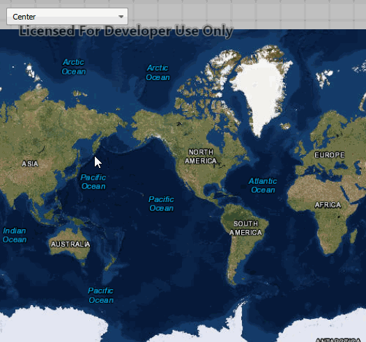

One way this issue manifests itself is through slow draw performance of raster tile layers (commonly called tiled layers) from an online service. When the problem occurs, you will see something like what is shown in the images below. The images below show the C++ Change Viewpoint sample as the viewpoint drop-down is changed to Geometry or Animation.
This issue is not specific to this sample. The examples shown above are extreme, but all network data retrieval performance will be affected to some degree.
