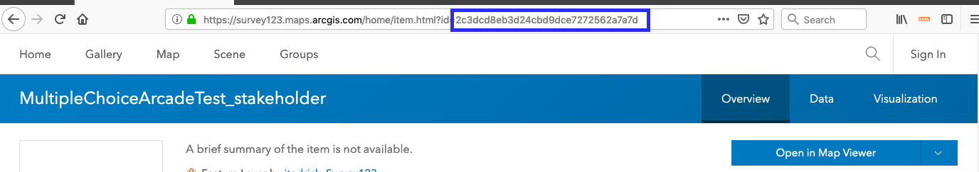

In most cases, the submission_url is generated automatically by Survey123 Connect when it creates a feature service.  As mentioned below, the easiest way to get the item ID is to copy it from the Item Details page; the rest of the URL is a set pattern shown in the documentation

The URL you have is the Feature Service's URL.  The easiest place to go to get the URL is the Item Details page in ArcGIS Online for the feature service:
