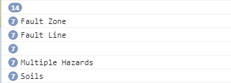

I am trying with the expand but not getting the desired result :
var layerList2 = new LayerList({ view: view, container: document.createElement("div"), listItemCreatedFunction: function (event) { item = event.item; item.panel = { content: "legend" }; } });
var expandLyr = new Expand({ view: view, content: layerList2.domNode, expandTooltip: "Layers With Legend", collaseTooltip: "Layers With Legend", expandIconClass: "esri-icon-layers" });
view.ui.add(expandLyr, "bottom-right");
watchUtils.when(layerList2, 'operationalItems.length', function ()
setTimeout(function ()
var lis = query('li[aria-labelledby $= "__title"]', expandLyr.domNode);
console.log("LIS ", lis);
lis.map(function (li)
 console.log(li.innerText);
}, 0)
Results :
Notice that only subs have a innerText. How do I get around this as I need to remove these from the layerList
I do not have this issue with the layerList by itself; only with Expand
RichardRhone
Issue resolved by putting the code outside view.when()
