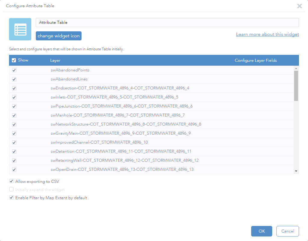

My understanding of this subject....
  • feature service - the REST endpoint published from either your own server, or ESRI. The feature service can stand on it's own and does not need to used in AGOL or Portal Items. A feature service can contain one or more features i.e. "feature/0", "feature/1", that each are part of the parent feature service.
  • feature layer - either an AGOL or Portal item created from a feature service. Where this gets confusing is the whole AGOL/Portal item is usually referred to as a "feature layer", but it can also contain feature "sub layers" if the feature service had more than one feature. These sub layers each get their own "child" page.
  • hosted feature layer - feature layer in AGOL, where ESRI is hosting the feature service for you
someone please chime in with corrections. The terminology around all this quite confusing and used inconsistently around the web
