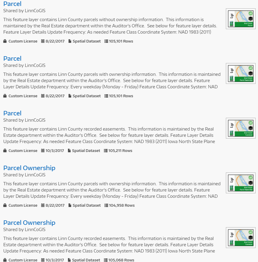

Using the site is also pretty straight forward but I have found that our Open Data site returns results that are not expected, and are often times confusing.  For example, we have 2 parcel feature layers; one is simply the parcel geometry with no attribute information (Parcel), while the other includes attribute information (Parcel Ownership).  If I do a search for 'parcels' on our Open Data site, I would expect to have two returned parcel layers, each of the ones I just listed.  However, I see 6 items with the layer name of Parcel or Parcel Ownership, shown below.  To make things more confusing, the descriptions of these layers seem to mix and match what layer is actually referenced, some are parcels, some are easements.

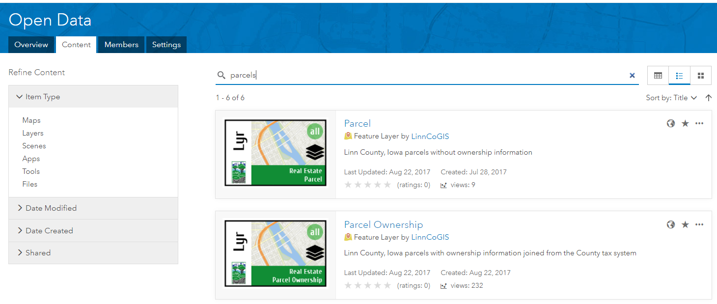

If I look at the group we use for sharing feature layers used for Open Data, and search for 'parcels', I get 2 parcel results, as expected...which makes me wonder why Open Data is returning so many layers???
